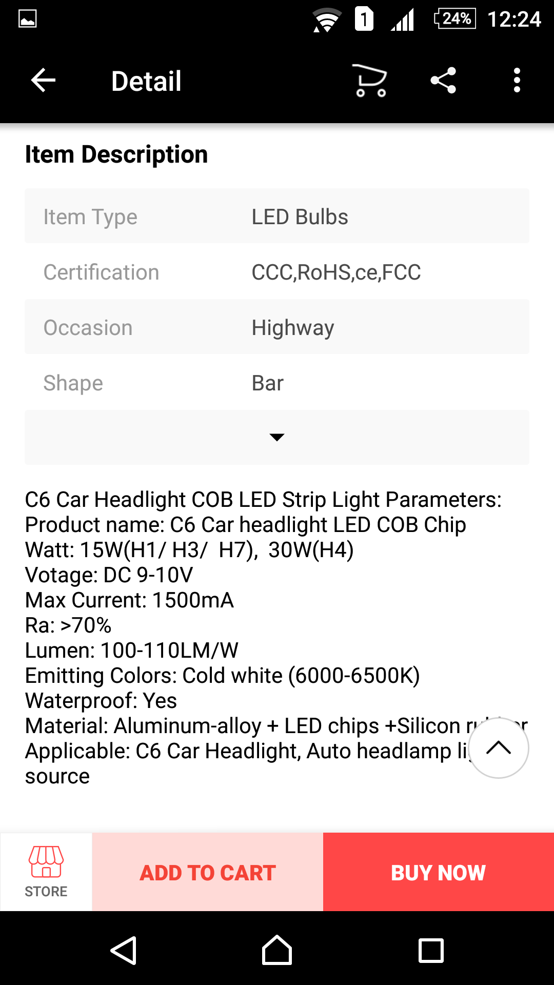

Anyone knows an alternate for LEDA(qx9920).. Because it is used in the circuit, unfortunately it burned.. Now i made this post to rebuild the circuit... This circuit is a c6 h4 led..

My project is to rebuild this burned circuit...
The details of the cob provided here
