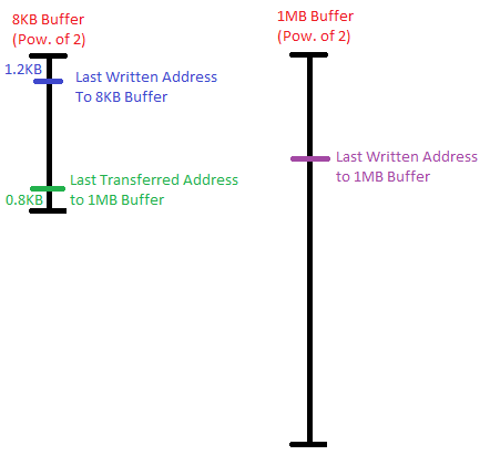

I also face the following problem:
In this case, I'd need to tell the DMA to move Data of size of only 0.8KB from Last-Transferred-Address-to-1MB-Buffer.
How can one "see" it efficiently?
as it takes here to:
1. firstly check if (Last-Transferred-Address-to-1MB-Buffer) > (Last-Written-Address-to-10KB-Buffer)
2. If yes, then Size = (10KB-Buffer-Ending-Address) - (Last-Transferred-Address-to-1MB-Buffer)
How does that help for efficient circularity in the 1MB Buffer, using the DMA?
It doesn't.. It only helps with the efficiency of the software buffer. DMA is designed to be efficient way to move data around.. don't try to make it any more efficient in software. That is impossible.
True.. no way around it.

How do you define the Head and Tail? (I didn't understand how you calculated the correct length please)
Head is the counter of what you wrote. It gets incremented for every byte you write, and it points to the place where you continue writing.
Tail is the counter of what you already took out with your DMA. It gets incremented for every byte you transfer with DMA, and it points to the place where untransferred data begins.
The size available for DMA transfers is the difference between the two. Size = Head - Tail;
Are you talking on a situation where we'd fail the calculate the correct length?
I'd appreciate it if you could elaborate on that please.
Say, the Tail&0x1fff is 0x1ff8 and you need to transfer 20 bytes. Apparently, you cannot do this in a single transfer, because DMA won't wrap. You need to transfer 8 bytes, then 12 from the beginning of the buffer. You'll have to deal with that somehow. There are many ways to do that.
Yes, I see now.
That is of course in the case where Head > Tail. (as you said below).
Yes, you're right.
However, how would you conclude that 20B are needed.
I mean, in the case you described:
Tail&0x1FFF = 0x1FF8
Head&0x1FFF = 0x000C
C:
Head&0x1FFF - Tail&0x1FFF gives you: 0x000C - 0x1FF8 = 0xE014
How do you reach the 20B in that case?
Would you ask at each time the Timer Expires:
C:
if (head&0x1FFF > tail&0x1FFF)   size = Head&0x1FFF - Tail&0x1FFF
else size = 0x2000 - Tail&0x1FFF
I'm trying to see if there's a smarter way to do it and recognize that Tail > Head
Head is always ahead of the Tail. That's why you call them Head and Tail. Therefore, Size = (Head - Tail) is always positive (could be zero, of course).
Yes, you're right.
How would you deal with it?
What would you find to be an efficient way of handling it?
There are many ways. Starting from straightforward - transfer only min(Size,(0x2000 - (Tail&0x1fff))), but this will add few cycles to every write, probably too slow for you. The other would be to do fixed size transfers, say 2048 at a time (e.g. if (Size >= 0x800) { transfer 0x800 bytes}). This adds less cycles, but introduces delays in transfer.
