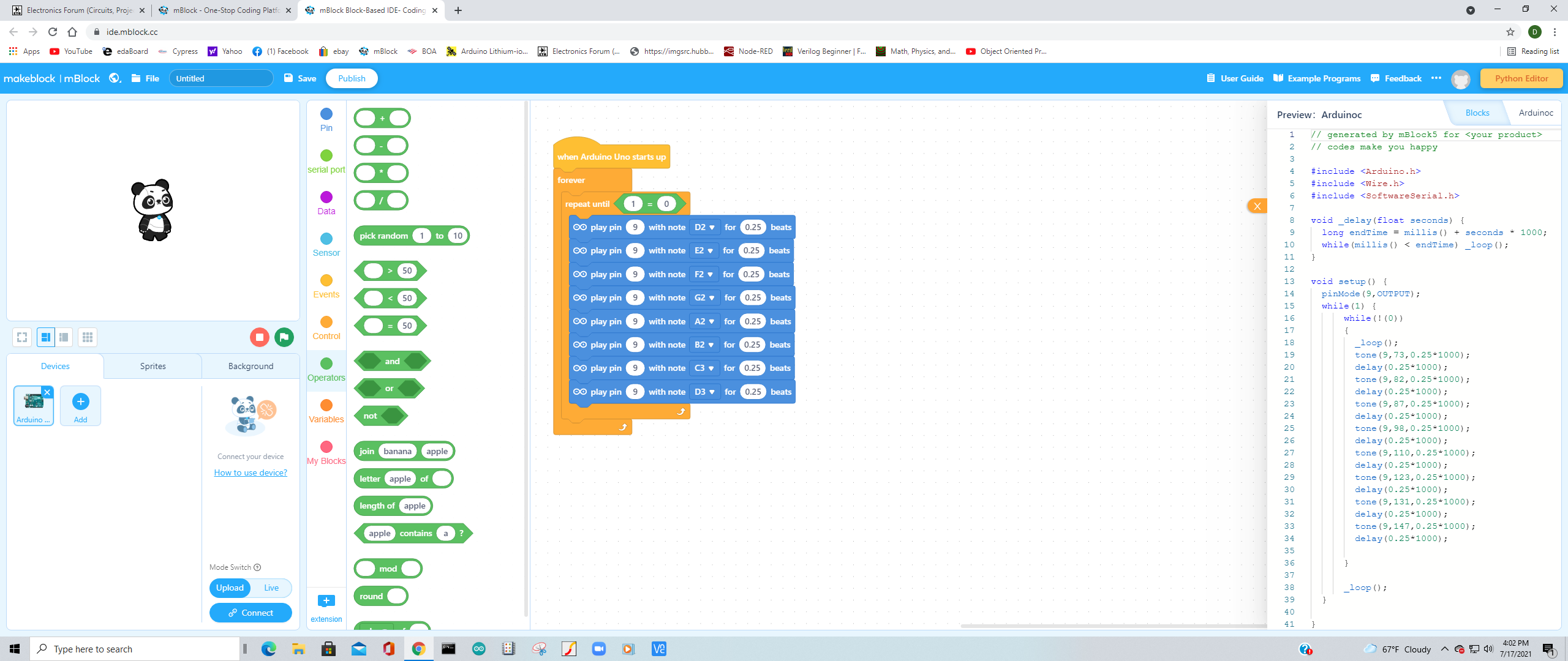

You can always do it in mBlock or Snap4arduino, freebee block languages.
Here is simple example, could have added blocks to test pins, etc.....
You drag and drop the blocks, and mBlock generates the code on the right and programs the
board.
Regards, Dana.
