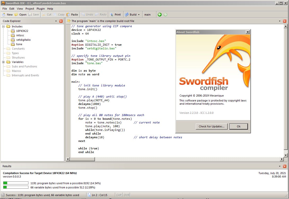

convertinf Ardunio code to Swordfish basic
I have version 2230 1200
sent email to website but?
I copied and repasted the two codes but still get the same errors. Won't compile AFTER I added a new copy of the tone.bas.
need to figure out a work around
I redid entire code on my wife's computer which shows it has version 2.2.3.6 icd 1.2.0.7
it compiles.
Thinking of just doing project code on her computer if the tone.bas module works as planned.
Don't know what to tell you. It all works fine for me.
You can install the SE version on your machine too... you can have both versions if you like
I don't know what to tell you. I have the SE version as well as the full paid version.

well Houston we have touch down!
I copied both suggested code from post #25 on wife's computer then put it on my computer and now it compiles etc. Using Swordfish 2230 1200
WHY??

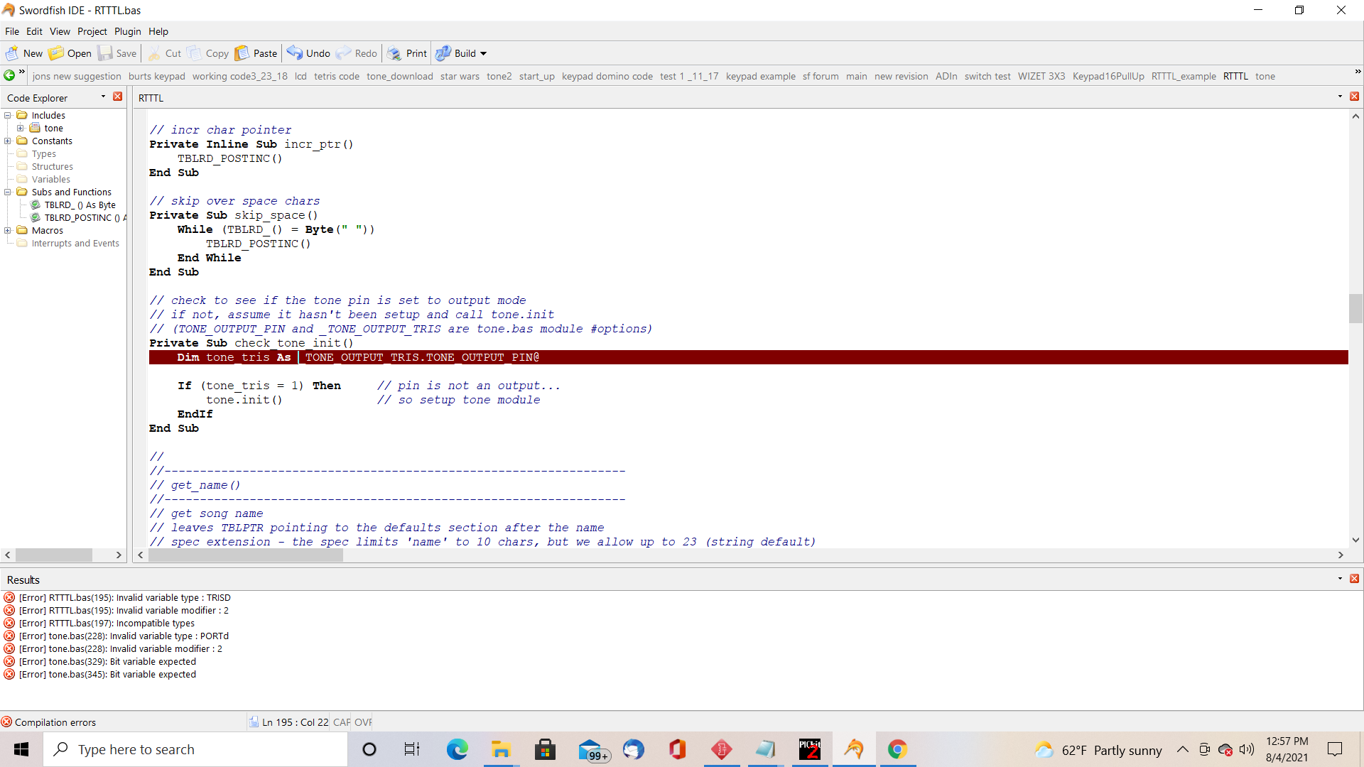

tried compiling the RTTTL example and get multiple compile errors.
I see there is an INCLUDE File named mplabcd.bas
can't locate
Of course it doesn't compile (for you). What errors are you getting?
Did you download and unzip both RTTTL and TONE files?
The tone.bas library is different than the version that was posted here... it has more features.
... which doesn't get included unless you've changed '#option _RTTTL_TRAP' or '#option _TONE_TRAP' and added '#option MPLAB_ICD = true'

For example, in post #35 the IDE shows you have two versions of the tone library.
One file is named 'tone.bas' and the other one is named 'tone(1).bas'
This happened when you were copying files and didn't let it over-write the old version.
That will not work... it will never include 'tone(1).bas', and there's a really good chance that's the file you want to use.

I eliminated ALL the tone.bas files and saved the tone.bas v10
still getting compiling errors?

I started a new copy and saved it in a different file location
saved TONE.BAS, RTTTL.BAS AND RTTTL EXAMPLE.
still wont compile
going to redo all the downloaded files (all three) and save in a different location.
using the links that Tumbleweed posted in post#48
I have NEVER used swordfish... Just downloaded.. Took the tone.bas and example... placed in a folder.. Compiled... 1 error.. too many variables... Changed variable list to fit.... Hey... Compiled and worked just fine.... Imperial march in me ears....
I just needed to see why the errors you are getting are simple ones.. ie TRISD not defined... Well... That's not good... Are you redefining the processor?
