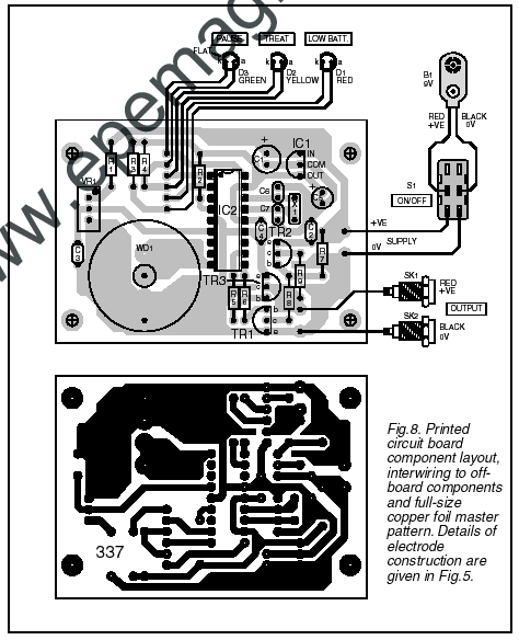

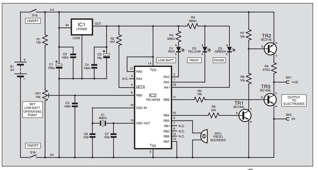

Ian.....i am trying to build circuit 1...the first one. already i build the PCB and the components are on place,But as i mentioned above i got stuck....
this one i am building.....Ian

I will simulate it... Two things... The hex file has to be for the chip you are using Andy used a pic16f84.. You can't use anything else unless you modify the code!!

At this point, I think the problem is more likely in the circuit as built. Ergoye should post the schematic and board design (if available) for what he thinks he has and an actual picture as assembled.
