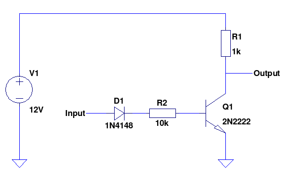

If all you need to do is convert it to a 12V squarewave and you're not bothered about the phase and duty cycle then this circuit will do.
Ecu siganl output is DC. (I hope. Does anyone know of a cheap oscillascope I can buy???)
The new tach looks at frequency but also requires 12V (or close to it) to drive it.
The duty cycle (on/off) of the ecu signal decreases with rpms. About 95% on at idle or 1300rpm (only 21Hz). I think inverting this won't be a problem.
Yes, that's one of the circuits that I came across looking up transistors. As well as the one that grounds the load through the transistor. Unfortunately I do not have access to the tach sginal ground. Only the common ground for the new tach.
My concern is the amount of current that the base draws (or leaks, I'm not sure of the terminology). I don't know how much current the ECU signal can source. Is this something I should be worried about?
Am I correct in thinking that transistors are primarily used to "amplify" current? Or can they be used in this manner to amplify voltage as well?
If the output from your tach is a sinewave then the output from this circuit will decrease in duty cycle with increasing input frequency.
You can increase R1 to 100k and R2 to 1M but then the load created by the EC might be a problem.
Another option would be to omit D1, reduce R2 to 100R, keep R1 at 1k, and change Q1 to 2N7000 which is a MOSFET and has a very high gate resistance >100M. This will only work if the output from your tach is at least 3V peak, I assumed you're talking about RMS when you said 3V to 5V.

So basically the open collector output functions the same as Hero999 transistor solution in post #4.
