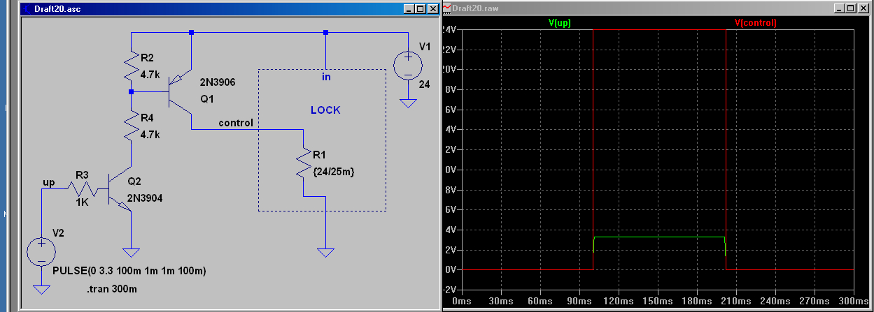

I'm making a circuit that involves a rotary latch mechanism. I'm going to use a 12V power supply for the latch and a 3.3V supply for the microcontroller.
The part I'm hung up on is the current draw on the rotary latch's control signal line. It says it will sink up to 25mA on the signal line when activated (granted that's at 24VDC, but it's the only datapoint they give). My original thought was to put a pull-up resistor from the signal line to 12V. Then an n-channel FET between the signal line and ground would control the latch. But if the signal line sinks even just a few mA, the pull-up resistor might drop too much voltage.
Next I thought of a push-pull circuit, but then there's the complexity of shoot-through prevention. Am I overthinking this, or is this actually a complex problem that a FET and a few passives can't solve by themselves?

My impression is that the external control signal must source current from a positive supply which is at least 12V. The source current required is 25mA if the source supply is 24V. Can we assume that it would half that (12.5mA) if the source is 12V?
Since it takes 12 to 24V to power the lock, then I would use that supply as the source of the control signal current. Here is my approach:
I wholly agree with MikeMI's approach. The statement "It says it will sink up to 25mA on the signal line when activated (granted that's at 24VDC)" gives sufficient data.

Input Signal Current Draw: 25mA
MAX at 24 VDC
It seems quite clear as to it's operated in the Wire Color Code / Connector Pin Assignment section. Coil requires 8-26V, and the control signal needs 8-26V to operate; there's a single ground. MikeMI's post (#8) shows an appropriate drive circuit.
