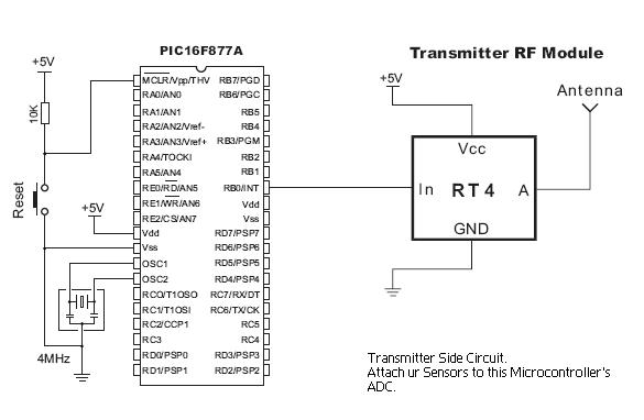

i also need ur help as i m going to make my study project with in
next 1 & half month, i m student of electronics engineering Final Year.
I hav an idea to get the information from surroundings by
sensors(temprature, pressure, light intensity etc) & then want to
transmit them wirelessely & thyen to recieve them & then show them on
computer , so want to interface my reciever to PC through
microcontroller.(also wish to send this data automaticaly to other
servers or system via internet)
Its seems lengthy & complex, so plz have a suggesion abt this project &
plz help me abt it.
also i welcome ur suggesions& imendments to make it better.

My view.

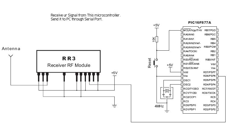

In my view use two Microcontrollers as in pictures.
Comunication between two Microcontrollers will be in Manchester codes...
Send data to PC through Serial Port...
u said that also wish to send this data automaticaly to other server or system via internet. ur software in computer will handle it self..
i mean when data will come to ur PC ur software will automaticaly send this data to other server..
Hope this Help

i request to "Nigel Goodwin" and "Papabravo" that tell me about my view...
And please don't ask me that where from it comes(i mean my views)..
