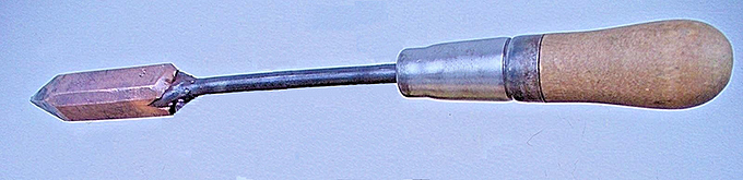

I use a 1950s traditional soldering iron with a huge square copper bit for doing heavy soldering- it works a treat. It has no electrical heating element; you heat it up in a gas torch. It's not too good for surface-mount work though.:D

Very interesting tool. They probably used that on lead piping :-)
Also looks like a medieval torture device :-)
Very interesting tool. They probably used that on lead piping :)
Also looks like a medieval torture device :)
Yes, its not intended for electrical work, but mainly for tin bashing, and the like.
I use it for copper bus bars, about 7mm in diameter, in audio amps, power supplies, etc.
It feels like a medieval torture device if you grab the wrong end.:eek:

The blacksmiths iron is also handy when you need to use high melting point solder.

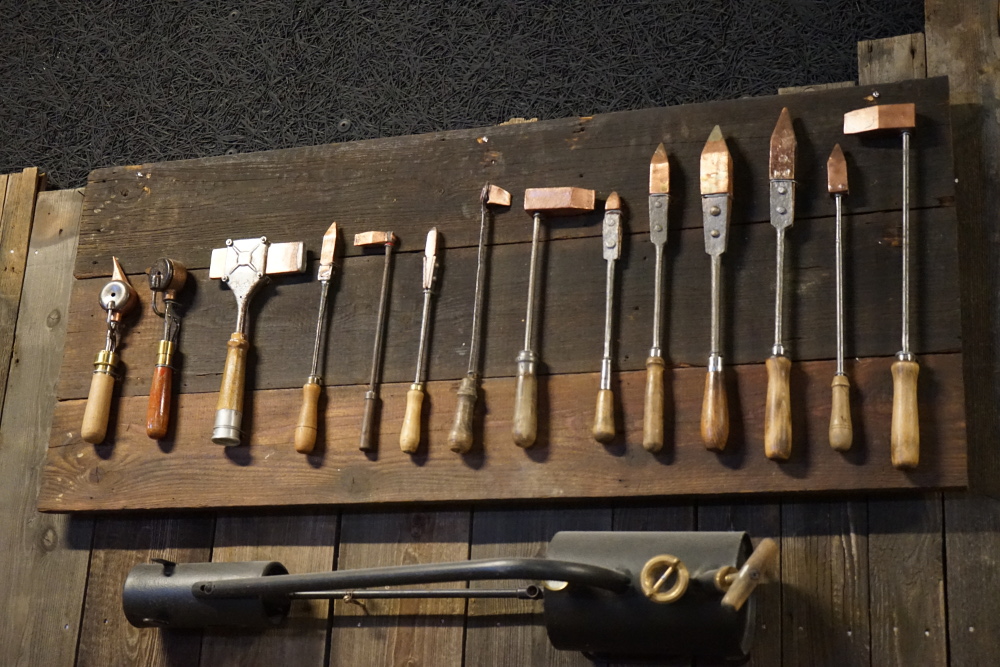

At the other end of the soldering iron range, I came across these no nonsense items in a museum in Germany earlier this year.
Big and chunky for a variety of applications.

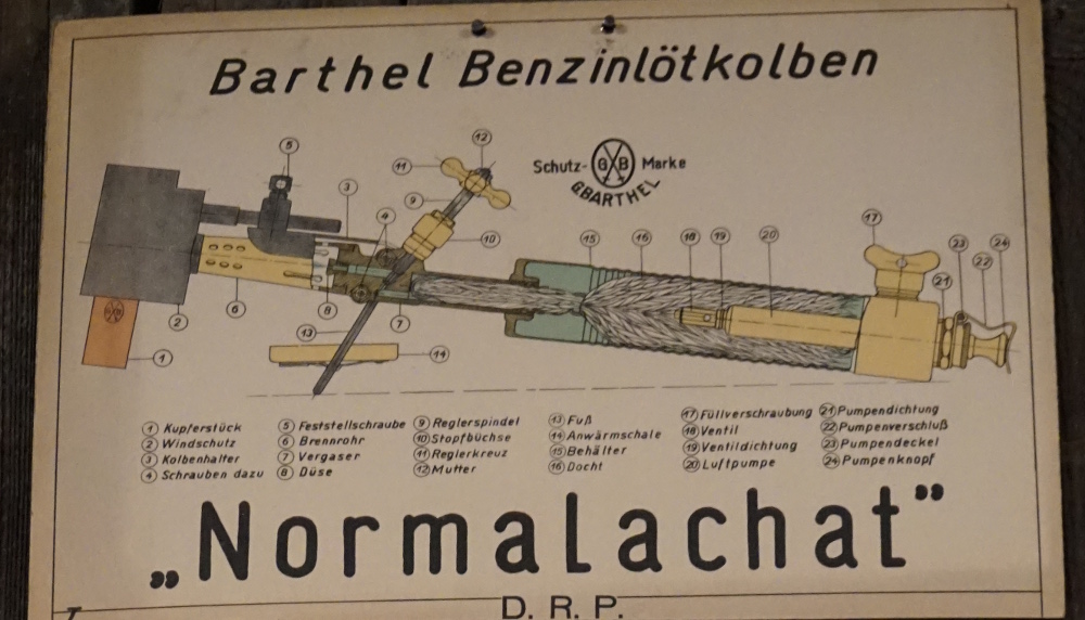

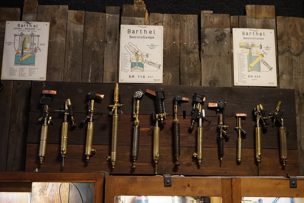

Here is something different, petrol powered soldering irons, they have a built-in blowlamp...

... as illustrated in this poster.

Wow, what a selection :-)
I had an old one that was very big but it was electric too. Maybe 300 watts, cant remember now.
I considered getting a big soldering gun but did not get it yet. I think it is around 400 watts.
I have used the big copper soldering tip on a big propane torch too, but dont have it anymore.
