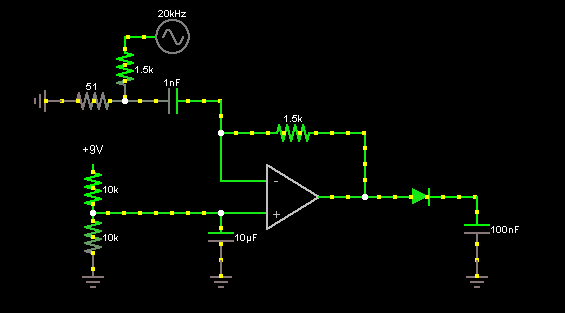

Okay after a few days of expirimenting and trying to dial in components I simulated a differentiator last night, a simple one, the schematic is shown in the attatchment below.

For now I will be focusing on only the trebble LED channel and I could use some advice for the circuit. My circuit I am testing now is very simple it is shown below.

So, you have an opamp with a 20kHz input. Your very long post unfortunately doesn't say what output you expect to get from that circuit, or what the problem is with the circuit (which is probably why you got no help from the other forum). :confused: Also, why do you want to amplify an ultrasonic frequency if this is part of a car audio system? BTW, any signal detected could be said to be a harmonic of some lower frequency, so it's unclear what your aim is here.
There are Audiogurus here (which I am not) but you can't measure it that way. You need to know the fundamental frequency and amplitude then do a good Band pass filter at the 3rd harmonic frequency to even come close.
Music has harmonics that are not distortion so your differentiator will detect them and your idea WILL NOT WORK!
Usual distortion from a sub-woofer amplifier is 200Hz or 300Hz. There is almost no distortion at 20kHz so your idea WILL NOT WORK!
First, I will not consider comparing the output to the input at all
That's the only way (directly or indirectly) you can detect harmonic distortion introduced by an amplifier system. If you don't know what the input is then measuring the output may well detect harmonics but it won't measure distortion (which, by definition, is the difference between the input and output).

Most amplifiers have low distortion at 1kHz and lower but the distortion normally increases at higher frequencies. You cannot hear the harmonics of 20kHz anyway.
If a sub-woofer amplifier is playing an 80Hz sine-wave then the strongest harmonics of clipping are at 160Hz and 240Hz. A very complicated highpass filter might reduce the 80Hz fundamental frequency to 1%. A very sharp notch filter can eliminate 80Hz but it will need adjustment for a good null.
when I play a 20khz sine wave I get and around 100-600khz or so harmonic distortion when I push the amp over it's limits and into where harmonic distortion and clipping occur.
It doesn't matter a jot if there's distortion above 20kHz. No one could hear it, even if the tweeter could reproduce it!

You can use complicated circuitry to compare the input to the attenuated and phase-corrected output or use a complicated distortion measuring circuit to determine when an audio amp.
I have made a few clipping detectors with a comparator that compared the output peak voltage to a reference voltage. But usually I use my ears to detect clipping unless it is horrible acid rock that distorts all the time.
Since your hearing's sensitivity to loudness is logarithmic (so you can hear a pin drop and hear a very loud jet airplane) then a simple comparator can compare the peak rectified output to a reference voltage that is near but a little less than when the amp clips. You probably need a peak detector since our vision is very slow.
I simply use my ears to detect clipping.

A 4th-order Butterworth highpass filter at 160Hz reduces 80Hz only 24dB which is 6.25% distortion which is a lot.
A clipping detector usually shows when the distortion reaches 0.1% or less.

A passive LC filter usually has only one inductor and one capacitor. The inductor is pretty big for audio frequencies.
A 7th-order active lowpass filter uses many opamps, resistors and capacitors, no inductors.
If your generator is accurate then a good notch filter is made with only one opamp.
What do you mean by generator and why do you mention notch filter, do you suggest one? As far as alot of opamps go I can use quad opamp packages.
An audio generator is a low distortion sinewave oscillator.
A simple notch filter can remove the fundamental frequency leaving the distortion harmonics at full level.
