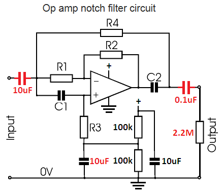

So, I noticed, with the volume down it dosn't distort. What is funny is that with the dual supply I was able to get the volume up high where the preamp starts clipping. Now I cannot. When I turn it high the positive half of the waveform is clipped at 0v and negative has some waveform which looks bad.
Should I use a larger power supply resistor?
Also, I am going to try using 3M and 4M resistors on the output to see if it works.
I forgot the EXTREMELY important input coupling capacitor and an output coupling capacitor.
That's right I forgot about that aswell.

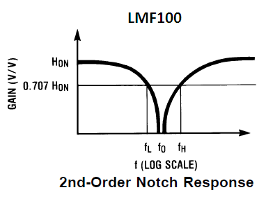

Sounds interesting...about the LMF100 you mentioned, I looked it up earlier and I don't understand it, it says that it can filter upto like 4th order, isn't that 24db or so?
The datasheet for the LMF100 switched capacitor filter IC shows how it can be an allpass, highpass, notch, bandpass or lowpass filter.
I used it as a notch filter in my distortion analyser. The notch can have a very high Q.
