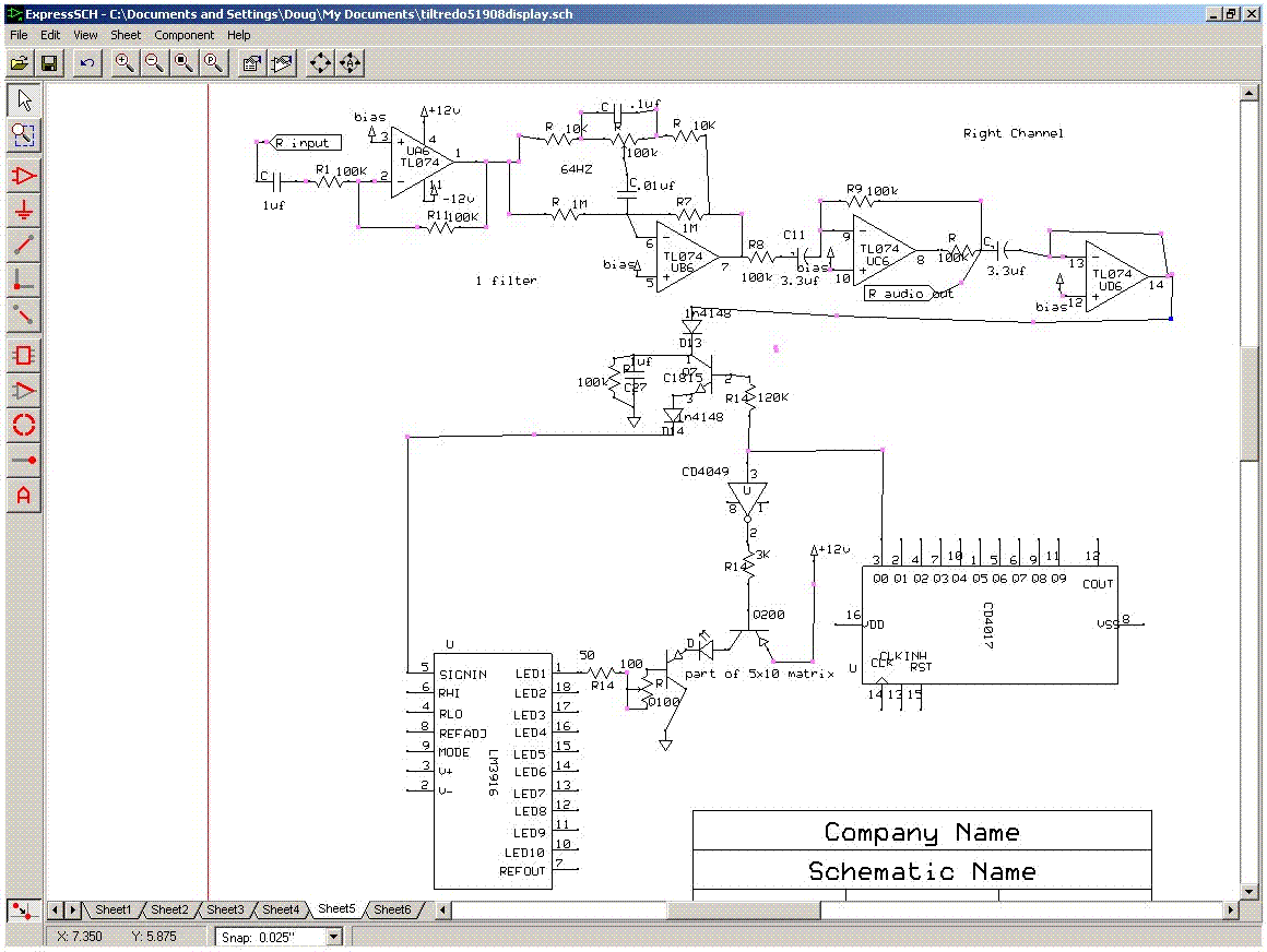

Here is my proposed circuit for 2-5x10 led matrix displays.
Only 1 led is showen for clarity.
attached is a description and pic
any corrections etc would be welcomed
  • tiltredo51908display.pdf
  • display operation.zip

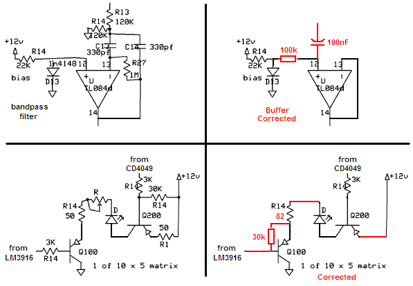

Hi Mr DEB,
Your "buffer" is actually the old bandpass filter from the Oriental circuit. I changed it into a buffer since you are using different bandpass filters.
Your transistors have too many resistors and one is missing.
The description is a word doc. Best way to post file?? Here is a copy/paste
Audio in from filter is isolated from clean audio by the op amp buffer.
Output from buffer is feed to a peak detector composed of diode and 1uf capacitor (D3, C27)
Transistor Q7 is turned on with a low from the cd4017 output.
The input of cd4049 is then high, turning on transistor Q200(1 of 5 colums)
Q200 enables the row of 10 leds which are turned on according to outputs from lm3916
The trim pot is to adjust intensity of different color leds. The 50 ohm resistor acts as a safeguard against excessive current.
Leds are fed a burst current of 150-200ma according to color (adjusted by trim pot). The leds are only on for a split second according to the adjustment of the cd4017 timing.
"Audio in from filter is isolated from clean audio by the op amp buffer."
Yes.
"Output from buffer is feed to a peak detector composed of diode and 1uf capacitor (D3, C27)"
A 100k resistor is supposed to be in parallel with the 1uF capacitor to slowly discharge it.
"Transistor Q7 is turned on with a low from the cd4017 output."
No. The output from the CD4017 is high which turns on Q7.
"The input of cd4049 is then high, turning on transistor Q200(1 of 5 colums)"
Yes.
"Q200 enables the row of 10 leds which are turned on according to outputs from lm3916"
No. Q200 turns on a column and the LM3916 shows up to 10 rows.
"The trim pot is to adjust intensity of different color leds. The 50 ohm resistor acts as a safeguard against excessive current."
You don't need two 50 ohms resistors. Use one 82 ohms instead. Use a trimpot if you want.
"Leds are fed a burst current of 150-200ma according to color (adjusted by trim pot). The leds are only on for a split second according to the adjustment of the cd4017 timing."
You had two 50 ohms resistors which limit the current in 2V red LEDs to only 85mA. One 82 ohm resistor will limit the current to 104mA so the LEDs will look like they have 20ma continuously.

in your diagram where does the 100nf cap connect to?
In the oritental circuit he shows only the 22k resistor, the diode to groud.
In Tina simulation it shows only 360mv for bias (I need to remeasure but pretty sure 360mv is close??)
need to switch around transistors.
The oriental circuit has 2 transistors per frequency but this one has 3 (alo of transistors).
gots to be a better method??
It is from the audio output of a filter.
In the oritental circuit he shows only the 22k resistor, the diode to ground.
The diode will have about 700mV across it.
No. The transistors are fine.
got to be a better method??
The Oriental circuit has the LM3914 directly driving the rows of LEDs with a very low average current. Your circuit has transistors to give a high peak current for good brightness.
You could use many fewer parts if a separate LM3916 drives its own row of LEDs continuously without multiplexing. Then 60 transistors are not needed for the same brightness.

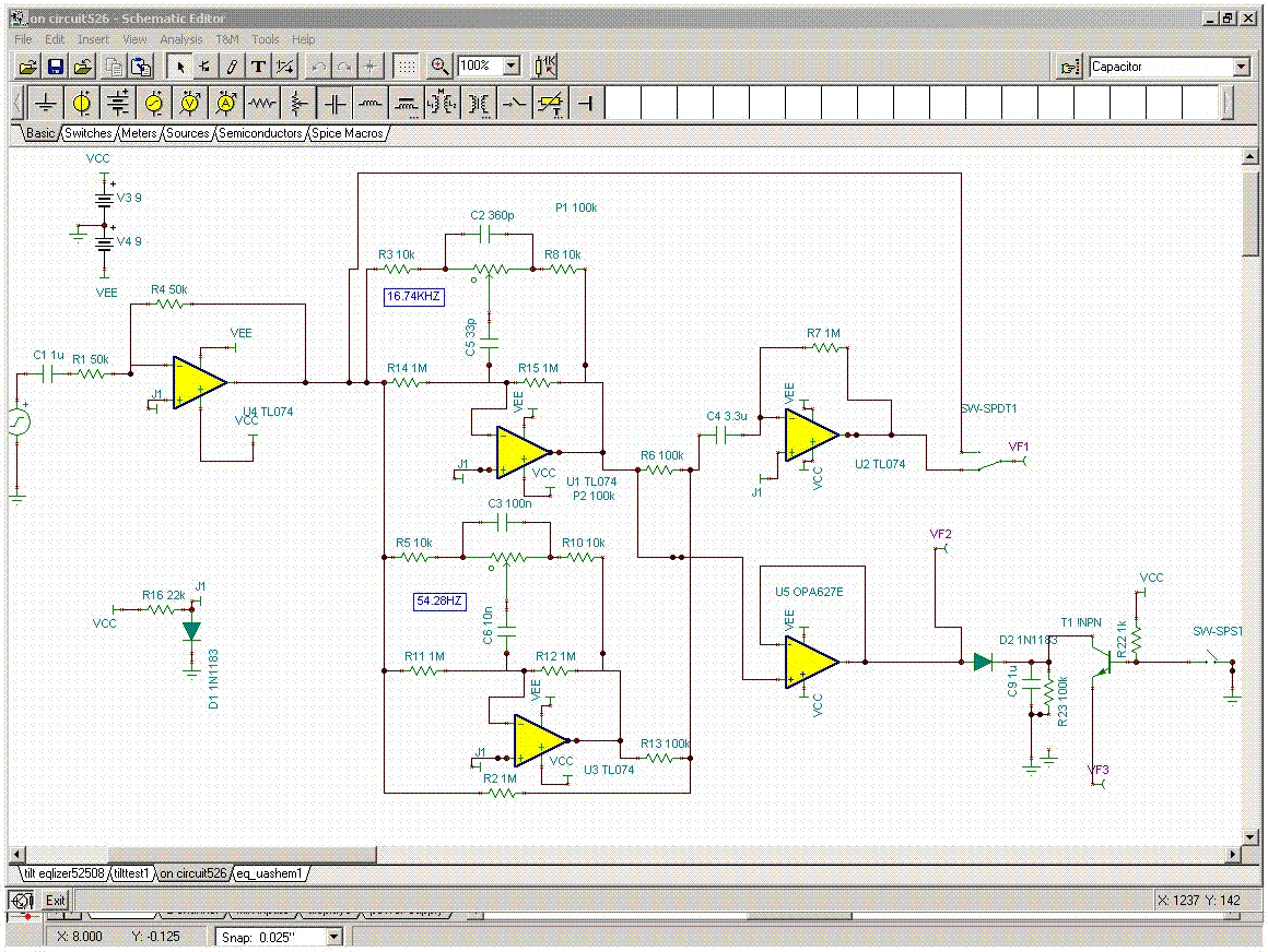

I attached a pic of filter w/ display drivers.
I changed the resistors on the lm3916 to 50 and put a 100 ohm trim pot. I have several different colored leds(red, green, yellow, blue) all take a different current and intensity levels so to even things out I put in trim pots. (10 for $1)
I got TINA simulation working right so I know the filters work as predected.

You are making mistake after mistake:
1) Your opamp has a 100k resistor at its output that feeds the virtual ground inverting input of another opamp. There is no signal voltage there for the audio output and for the negative feedback.
2) there is no current-limiting resistor for the LED anymore. You are feeding a huge base current into the left transistor and a pretty high base current into the right transistor and the LED will smoke and burn (or the power supply will instead).
There is nothing to turn off the left transistor.
3) The diode is missing from the bias of an opamp so its output voltage will be too low for the peak detector.

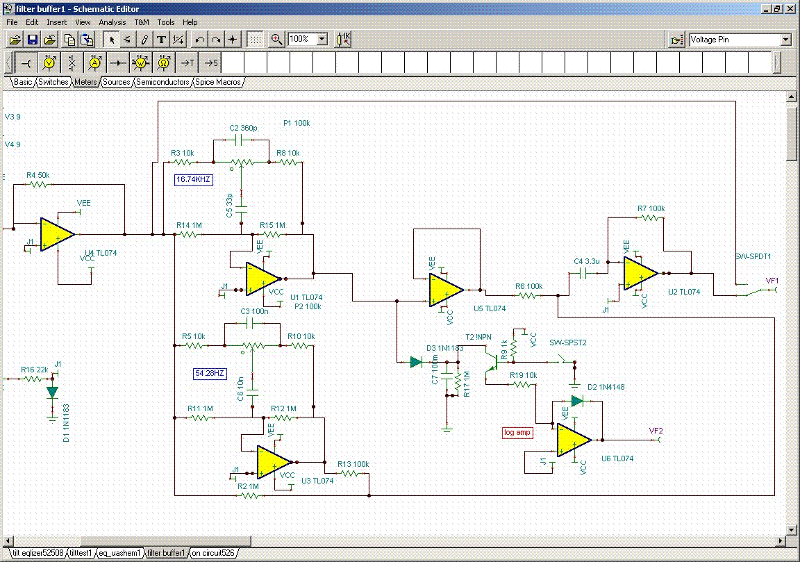

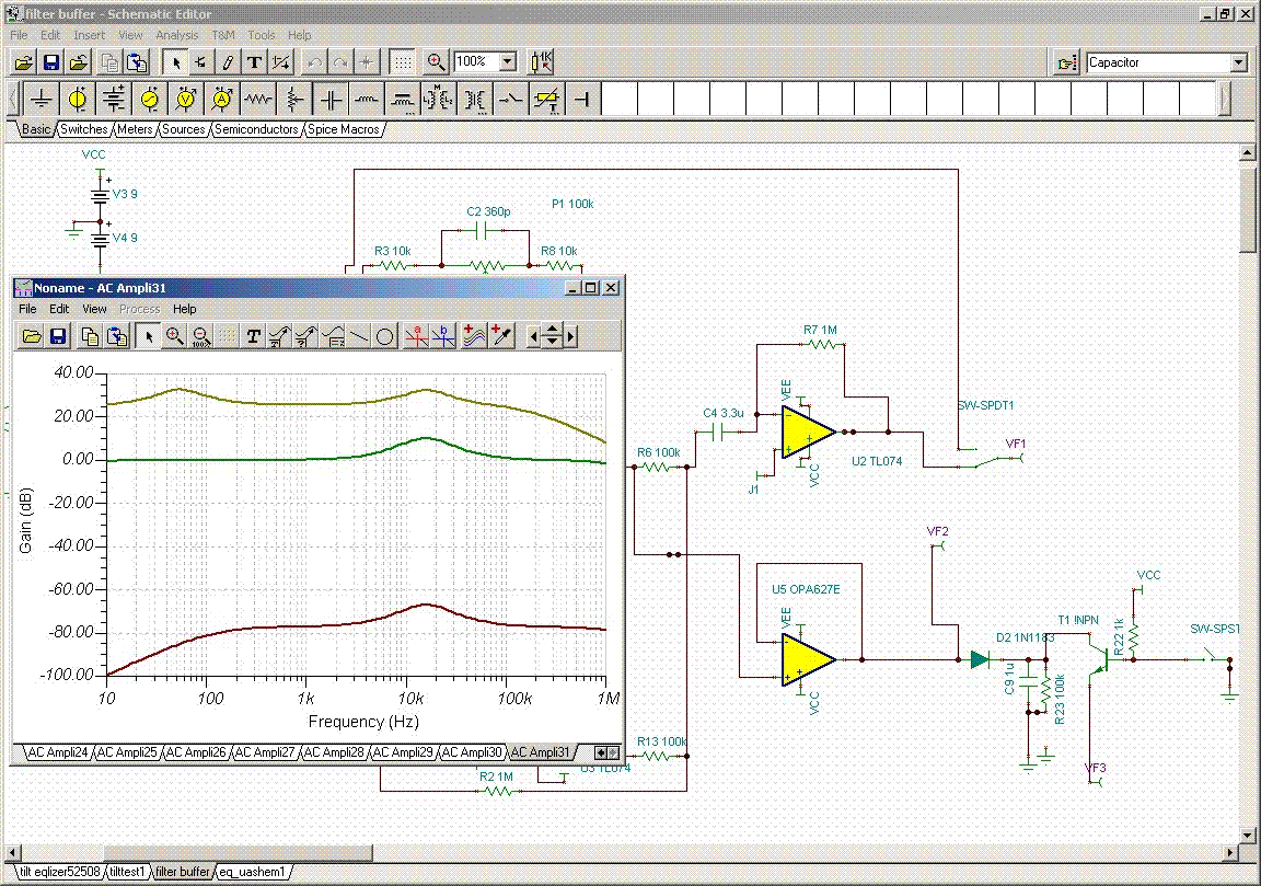

I moved the buffer
In simulation this works?

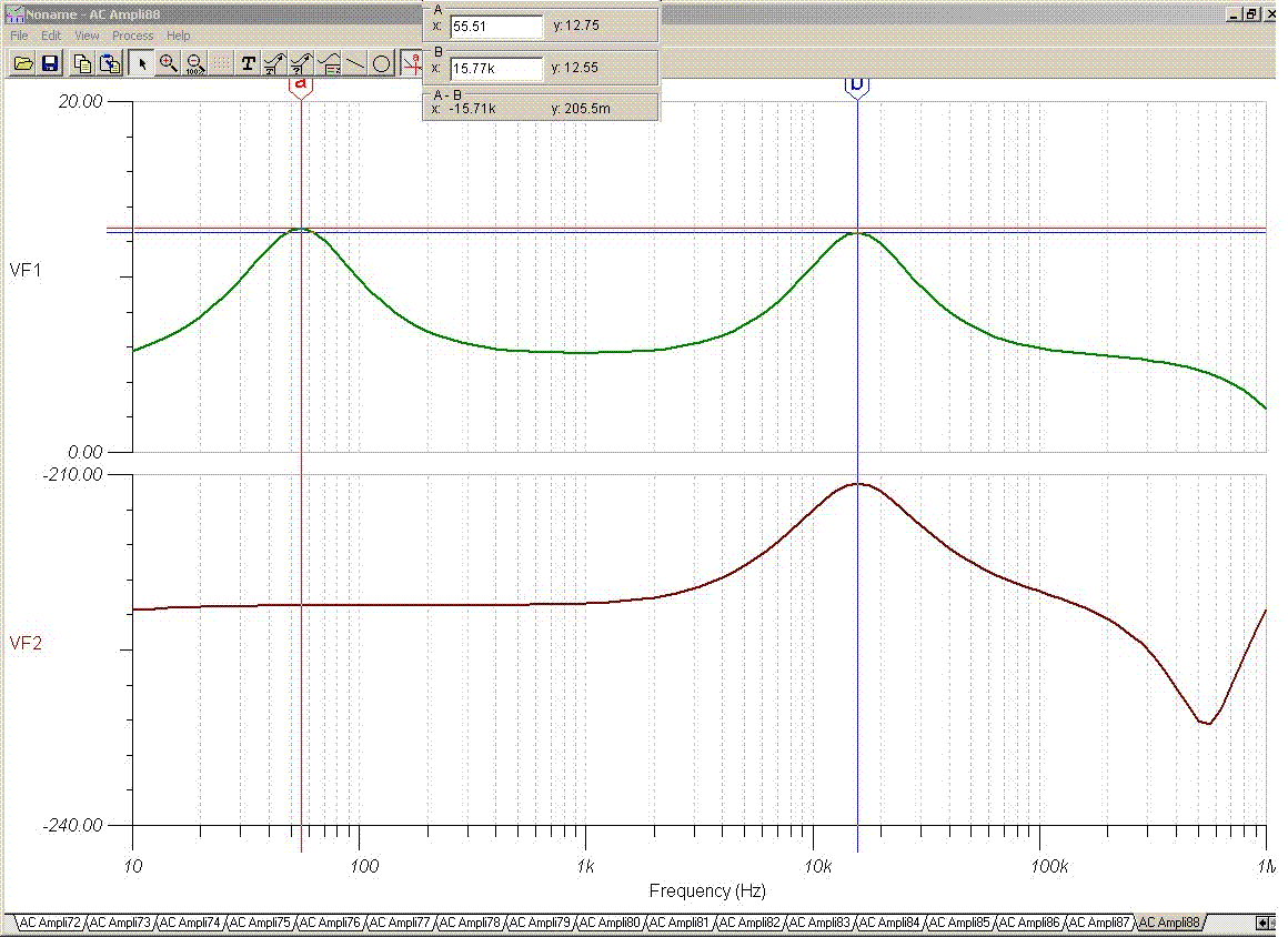

Getting somewhere w/ circuit
After moving parts around I found where to insert the peak detector/log amp circuit.
Am assuming the log amp will improve the performance of the lm3914?
I forgot to remove the transistor/switch combo. Shouldn't make a difference
Hi Mr DEB,
Your log amp has nothing to zero it so its output might be at +10.8V most of the time.
Its output should be at about -0.5V without a signal and be at -0.63V with a very strong signal. The tiny output swing of only 0.13V will not be seen on an LM3914 display.
If it is amplified then the log circuit makes a pretty good thermometer since its output changes with temperature.
The log amp will need exra parts to make it temperature-stable and its output needs an inverting amplifier.
