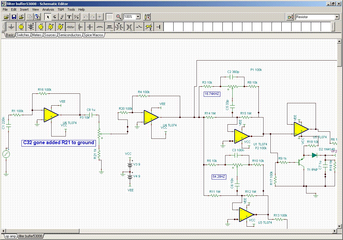

CD4066 questions?
With the split 9v supply the cd4066 won't work?
Data sheet says INPUTS -.5v TO Vdd + .5v
what will lowering the supply voltage do?
If I understand you correctly I need a lower supply voltage to the CD4066?
If so wouldn't a simple diode in the Vdd of the CD 4066 cause a voltage drop?
Other better switches for this application?
will simulate removing C32
revamped circuit
Removed C32 but added a 1K resistor to ground from 10K pot so the input to U1a won't get grounded directly (???)
sweep diagrams look same w or w/o C32
Just waiting on concensus of the CD4066 see previous posts

The input to the CD4066 is from -8V to +8V.
Its power supply voltages must include these voltages. Use -9V and +9V to power it.
A CD4066 made by Texas Instruments has a max allowed total supply of 20V.
The control pin must swing from -9V when it is off to +9V when it is on.
A resistor is missing at the output of the top filter opamp that is the equivalent to R13 on the second filter.

Hi Mr. DEB,
The CD4066 has inputs that swing from -8V to +8V so its negative power supply and for the control input and for the indicator LED must be -9v, not 0V.
The LM3916 ICs will cause noise on the +9V power supply voltage when they switch between no current to about 1.25A so add a 100uF capacitor to the supply pins of each LM3916 to smooth the voltage.
Hi Blue Bill,
The LM3916 has a max allowed dissipation of 1.365W. I didn't calculate the max adjustable current for each LED but if they are 25mA and all 10 are turned on then the dissipation in the LM3916 is (9V-2V) x (25mA x 10)= 1.75W which is too high. The 15 ohm resistor will dissipate 0.94W and reduce the dissipation of the IC.
If I understand correctly?
Instead of going to ground with the control pins to OPEN the switch I need to connect to the -9 supply?
Will add the 100uf to the supply pins.
The CD4066 needs to have a -9V and a +9V supply.
Its is turned off when its control pin at -9V and it is turned on when its control pin is at +9V. The indicator LED also needs to connect to -9V and its resistor value doubled.

The CD4066 and most other Cmos ICs have a max allowed input signal level that is within their supply voltage range. Your signals go from -8V to +8V so the supply voltage for your CD4066 must be at least -8V and +8V (the datasheet allows 0.5V more input).
Your schematics are confusing because the supplies are -12V and +12V on one page but -9V and +9V on another page. I think you are using only -9V and +9V for everything.
