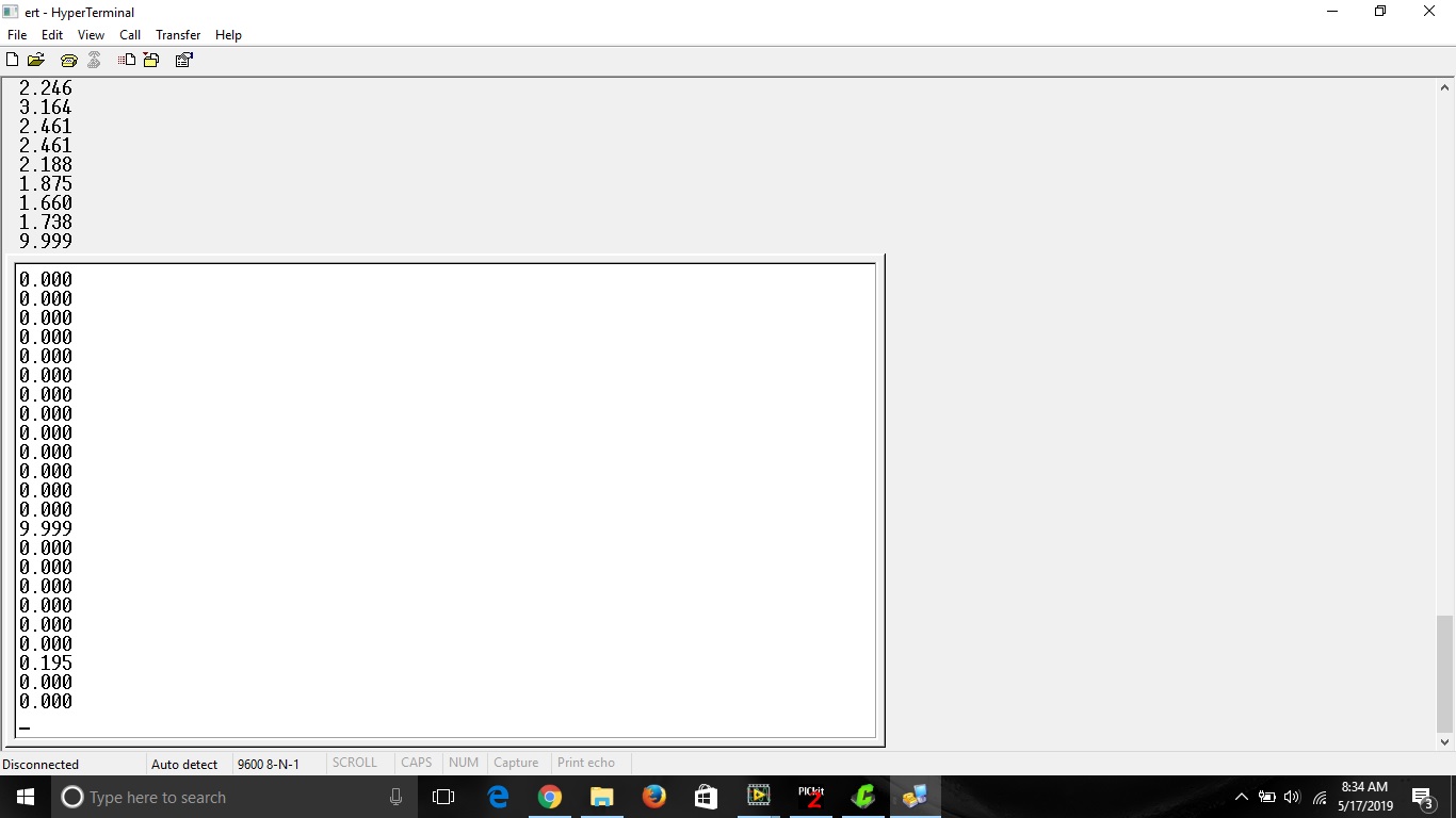

This morning i encountered a problem with the hyper terminal which I'm using to display ADC data from dspic. Last Friday I tried to read the data from dspic with labview using port COM3 and it was able to display on the front panel in labview. For your information, I closed and exit the hyper terminal program before I opened labview and vice versa. Now both program are unable to display the data. In hyper terminal the message displayed "Another program is using the selected telephony device. Try again after the program completes". I exit all programs and restart my laptop several times but the message remains. Can anyone guide me how to solve this problem? I'm using windows 10.
Regards
FR
Check in device manager to make sure COM3 has no driver errors?
I've had similar errors in Realterm a couple of times when I've managed to crash it, but they can often be fixed by opening and closing the program & attempting to reconfigure the com port a couple of times, or simply rebooting.
A fault that persists through reboots and power cycling seems like a driver or hardware problem...
What is COM3? A plug-in serial card or a USB adapter?
Edit - if it is a USB device, check in device manager if the driver has auto updated. If t has, roll it back to the previous version.
There was a similar problem a few years ago with some USB serial devices..
If it's a USB serial adapter, is it a genuine FTDI type or a clone?
Thank you for the reply. The devices i referring to is a USB serial adapter and its genuine FTDI type. What I did i clicked on control panel> hardware&sound> device and printer> FT232R usb uart> (right click) troubleshoot> follow instructions on screen. It works. Thanks for the guide.

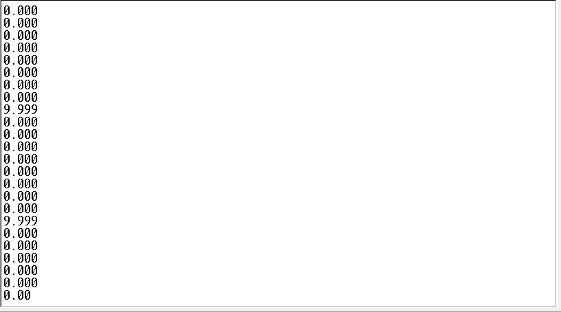

I have some other problem when read ADC data from the PIC. I created a program using for loop because I want to make sure I received all data according to how many loops i wanted. For example if I set the for loop to run 3 times (0,1,2) than on the hyper terminal I will received 3x9 data including 9.999 (marked as end of data for each iteration). But the problem is at the last iteration the data displayed less than 9. IS it because of the ADC
CSS:
#include <18F4580.h>
#device ADC=8
#fuses HS,NOWDT,NOPROTECT,NOLVP
#use delay(clock=20000000)
#use rs232(baud=9600, xmit=PIN_C6, rcv=PIN_C7)
#define button (PIN_B0)
void main()
  setup_adc_ports(ALL_ANALOG);
  setup_adc(ADC_CLOCK_DIV_64 | ADC_TAD_MUL_8);
  set_TRIS_B(0x0F);
  const int8 channel_1[] = 0,1,2,3,4,5,6,7;
  int start;
  int16 ADC_value1[sizeof(channel_1)];
  //int16 ADC_value[sizeof(channel_1)];
  int32 value1;
  int32 voltage[sizeof(channel_1)];
  SETUP_ADC_PORTS(ALL_ANALOG);
  //while(TRUE)
  for(start=0; start<=2;start++)// acquire 8 measurements in 10 ONLY
    LOOP1:
    if(input_state(PIN_B2) ==0)//if not pres==0, LED ON/OFF 0.5sec
    delay_ms(100);
    output_b(00000000);
    delay_ms(100);
    output_b(11000000);
    goto LOOP1;
    //break;
    else // if pressed (HIGH) start acquisition
      // Collect ADC_DATA IN CHANNEL_1
      for(value1 = 0; value1 < sizeof(channel_1); value1++)
      // Read from 8 adc channels
        set_adc_channel(channel_1[value1]);
        ADC_value1[value1] = read_adc();  // ADC readings
        delay_ms(500);
        voltage[value1] = ADC_value1[value1] * (5 / 4096);
        // Convert ADC data to mV
      // Print all ADC data
      // Display 8 voltage values
        printf("%4.3w\r\n", voltage[value1]);
        printf("9.999\r\n");
buffer? First I set iteration to 10 and the problem occurs. Later, I change iteration to 3 the problem remains.
118356
Can anyone help me.
Regards
FR
I suspect the compiler is using buffered I/O and there are a few characters still in the transmit buffer when the program quits.
Try adding a dummy printf() after the output loop that eg. prints a block of 20 space characters, just to ensure all wanted data has been flushed through the serial buffers.
The reason you're getting zero is because, in integer maths, (5/4096)=0. Which is why I separated the calculations.
Edit, it also needs to be 5000 (not 5) to get mV or you need to use fp variables.

   ert_adc_value_0=read_adc();    //starts conversion & stored
   ert_voltages_0=(ert_adc_value_0)*5000/4096;// last result of last conversion
   printf("Ch0=%u\r\n",ert_voltages_0);
