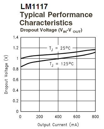

If you can't get a National Semiconductor LM1117, then maybe the NCP1117 is a copy-cat that is sold over where you are. Here is the datasheet for the LM1117:
Here is its typical (some will have a higher or lower voltage) dropout voltage:

Yea, what I found is almost similar to your attachment, but I've forgotten which semiconductor company I was searching to.

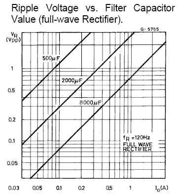

I have this graph for my 120Hz ripple frequency. The scale on its left side is the amount of peak-to-peak ripple voltage.
Note that big filter capacitors have a wide tolerance that could be -20%, +80%.

Oh, after the full wave rectifier and the filter capacitor, the ripple frequency is twice of the original supply frequency, 60Hz. Is the x-axis the output current? As you said before, the ripple voltage becomes higher when the current increases.

Obviously, suppose a 1000:mu: capacitor has a tollerance of -20%, +80%, there's a chance it might really be a 800:mu: capacitor which would give you more ripple.
Use the following formula to calculate the minimum capacitor value with a fullwave rectifier:
[latex]C = \frac{I{LOAD}}{2FV_{RIPPLE}}[/latex]
Where:
Vripple = maximum allowable ripple, the peak transformer output voltage (1.4 times RMS) minus the diode drops and regulator droput.
F = Line frequency, 50/60Hz.

  2. I defined that formula myself, a linear regulator is a constant current load. The capacitor discharges linearly between AC cycles so the minimum capacitor size is proportional to the load current and inversely proportional to the frequency (which is double, hence the *2 term), maximum allowable ripple. I have tested this formula both with simulation software and in practice and it generates consistant results, if you see it in a book or on another websit then please tell me, I'm interested.

If no load was connected then you won't see any ripple. A 470:mu:F capacitor will give 1V of ripple at 47mA if your power frequency is 50Hz and 833mV if it's 60Hz. Of course you sould be prepared for the capacitor bieng 376:mu:F which would give a 1.25V ripple @50Hz.

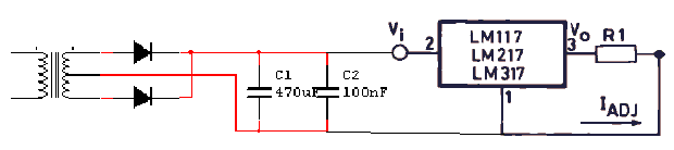

One LM317 and a resistor? I see a current regulator there. Somewhere has to be connected to the ground right? Otherwise it acts as opened circuit, like no load.
Obviously it needs a ground connection.
Go on, post the circuit taken from the circuit and annotate it showing the +V and 0V connections. I'm sure you can guess.
I guess this. If the resistor is 12:eek:hm:, the load current is around 100mA. Right?
