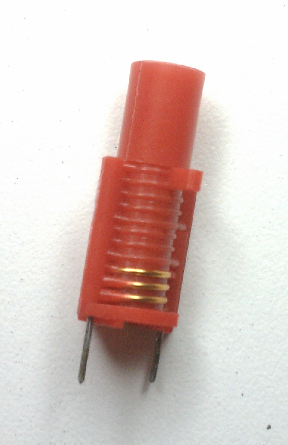

Aren't PLL's fun?Sounds like you still have some loop issues. With the scope you want to look at TP2. Ideally you would have a pure DC component but in the real world there will be some AC component. With the scope you should be able to see how stable or unstable your loop is. You might try increasing the value of C24. For L1 you might try to rewind your coil so it looks like the image below. I also recommend you read up on PLL's and particular read up on loop filters. Here is a few links.

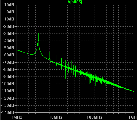

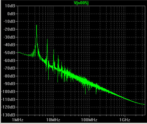

To give you an idea of how Q of an inductor affects oscillator performance I have a simulated a PLL osc with a low Q tank inductor and a Hi Q inductor. Notice the phase noise of the low Q tank is much greater. See below. Low Q image is on the left.
