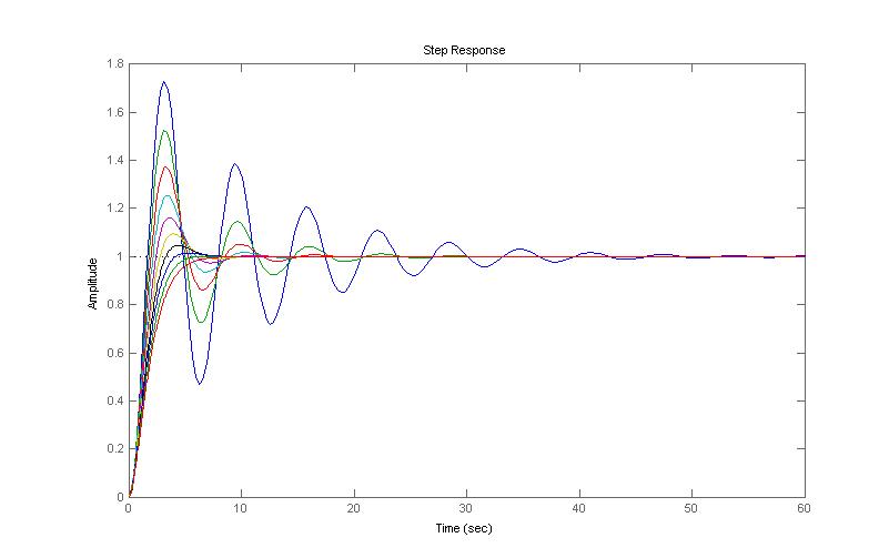

The most known, most used, actually the first name that any Teacher in any University of any country I think will mention in the very first class of any Control Theory course in the World, is MATLAB.
In the attachement, I simulated the step response (a response to a Heaviside step) for different values of damping, from .1 to 1 (From pseudo-periodic to critic, I didn't do the a-periodic when Ksi>1)
Can you please tell more about damping what the need and origin of damping...??an also about Ksi??

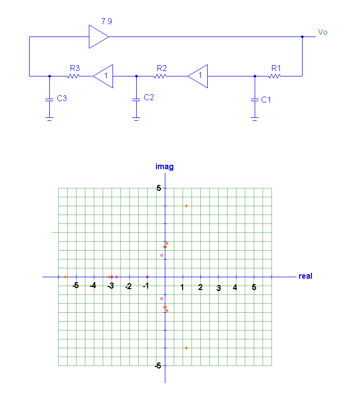

It helps to look at a very simple system with feedback that is known to oscillate with some value of the forward section gain.
In the attachment, we make all the resistors equal to 1 ohm and all the capacitors equal to 1 Farad for simplicity.
Evaluating the circuit, we get for the forward section:
G=gain of upper amplifier=G
and in the feedback section we get:
H=1/(s*R*C+1)^3
Thus the equation we use for the roots is:
1+G*H=(s^3*C^3*R^3+3*s^2*C^2*R^2+3*s*C*R+G+1)/(s*C*R+1)^3
Setting this equal to zero, we get:
(s^3*C^3*R^3+3*s^2*C^2*R^2+3*s*C*R+G+1)=0
This is the equation we solve to find the roots.
Since R=1 and C=1, we have:
s^3+3*s^2+3*s+G+1=0
which is a fairly simple third degree equation in the variable 's'.
Now we vary the gain G to see what effect it has on the roots.
Looking at the roots with G=0, we get three roots:
s=+0*j-1
s=-0*j-1
s=-1
Examining the real part of all three roots, we see that all of
the real parts are less than zero. This puts all the poles
in the left half plane so the system is stable.
Now we look at the roots with G=5, we get three approximate roots:
s=+1.48088*j-0.145012
s=-1.48088*j-0.145012
s=-2.7099759
Looking at the real parts of these three roots, we see that the
first two roots have migrated closer to zero so the system is
starting to become less stable. They are all still in the left
half plane so it is considered stable.
Now we look at the roots with G=7.9, we get three approximate roots:
s=+1.724803*j-0.004185
s=-1.724804*j-0.004185
s=-2.991632
Looking at the real parts of these roots now, we see that the
first two have gone down to very close to zero. The system is now
almost an oscillator.
Now lets look at the roots with G=8.1, we get roots:
s=+1.739237*j+0.004149
s=-1.739238*j+0.004149
s=-3.008299
Now we see that the real parts of the first two roots have moved into
the right half plane. The circuit is now an oscillator that may saturate
after some time.
With G=10 we get approximate roots:
s=+1.865795*j+0.077217
s=-1.865796*j+0.077217
s=-3.154435
and we see that the roots are moving farther into the right half plane.
With G=100 we get approximate roots:
s=+4.019733*j+1.320794
s=-4.019734*j+1.320794
s=-5.641589
and we see that the real parts of the first two roots moved even farther into the right half plane so the circuit is unstable.
In the diagram below we have the circuit and under that the pole constellation diagram drawn on the complex plane.
The red circles are for the sets of roots that dont have any part in the right half plane, while the orange dots are for the sets of roots that do have some roots in the right half plane.
Looking at the roots that are drawn as red circles, they are all in the left half plane.
Looking at the roots drawn as orange dots, two of the roots of those sets are in the right half plane.
There are no zeros in the transfer function so there are no zeros to consider.

In fig. the top most op-amp is used at a gain of 7.9, why you have taken 7.9 or any other value ...??
and then output of amplifier is feed to in put by using low pass filter then buffering signal with buffer ( of gain 1)..3 low pass filter are used like phase shift oscillator, acting as phase delay...
I am right??
Hi again,
We get H like that because that's what we get when we analyze the bottom section of the circuit from output back to input.
Im sorry, it's supposed to be typed as 1/(s*R*C+1), my mistake in typing. It's fixed now.
I took 7.9 for example because i knew beforehand that 8.0 was an important value for the gain G because that's when the roots cross the imaginary axis and the circuit becomes unstable.
I took G=0 because that's a good place to start the root determinations. Then, i let G grow larger and larger too see if any roots crossed over into the right half plane. I saw that as G got larger two of the roots moved closer to the j axis and then finally when G>8 they moved right into the right half plane so the circuit became unstable.
Yes this circuit could be a phase shift oscillator, but only with the right value of gain G. It wont oscillate unless the gain is at least 8. That's one of the things we like to determine when doing this kind of analysis.
When the gain is less than 8 the circuit is damped so it doesnt oscillate (stable). When the gain is 8 it oscillates (conditionally stable), and when the gain is greater than 8 it oscillates for a while and then saturates the system (unstable).
