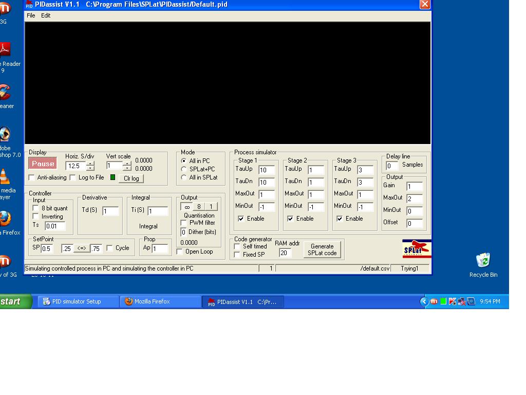

I have downloaded PID simulatin software no idea how it work..

I dont use that software. You'll have to look for instructions on the same site that you got it from.
