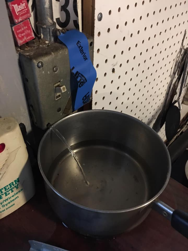

Reminds me of my problem last year. After a heavy rain, I would find a wet floor in my workshop. I have solar panels and inverters installed there. High voltage lines (350VDC) run down from the roof in PVC conduit, to a PVC transition box outside, then inside where it meets up with metal conduit to the inverters. Had water dripping from the metal conduit.
Went outside and opened the PVC transition boxes (2 of them), both had water in them. Seems somewhere up on the roof, there must be some opening that allows the water in, or it runs along the wires into the conduit. Has to drill two small drain holes in each transition box to allow future water to drain out. No more wet floor since then. Some day I'll have to get up on the 2 story roof to see where the water is getting in....
