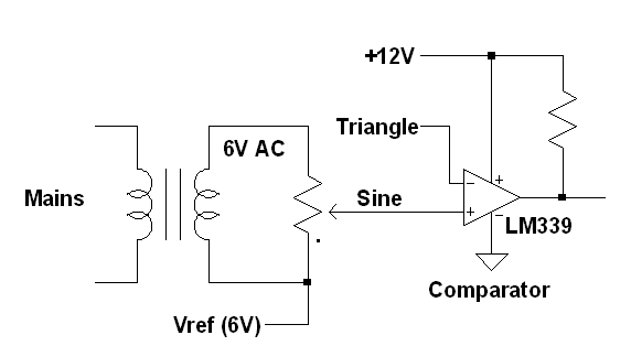

It is simple to properly bias the sinewave opamp.

And also, How to include the DC 6V inside a sine wave from the grid
Like this:-
I showed that adding a simple coupling capacitor to the input of the inverter allows it to be biased correctly since its (+) input is at +6V.
As Alec shows for your non-inverted signal from the grid, connect the common of the transformer to +6V.

As for the coupling capacitor, similar to the schematic. The (+) input is +6V but when I connect a simulated sine wave to the coupling capacitor, the sine wave become close to a straight line with slight ripple.
The coupling capacitor connects to the 10k ohms input resistor of the inverting opamp, it does not connect to ground. If its source is a fairly low resistance potentiometer then its signal level should not change when it is connected.
Just a couple of questions, with regards to what alec_t said. Because I am using function generator to produce a 50Hz sine wave, if I were to connect 6VDC to it, wont it blow the generator because of the DC & AC issue.
