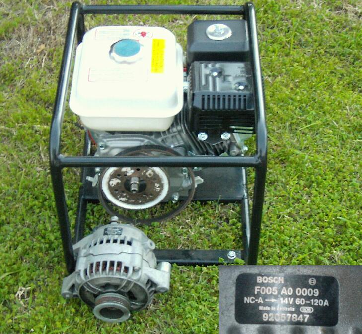

I was thinking of building a generator from an alternator to run my new welder...(a Millermatic 175)
this welder pulls 220v and 20 amps
is there any way to build a generator to run my welder and have an outlet for a 110V 20A outlet?

What motor would you use to turn it? You'll need 5.89812332 HP for 20 amps at 220V, assuming everything is nearly 100% efficient. (which it never is)

Inside a car engine bay the heat can do horrible things to an alternators efficiency. In an open air enviroment you can expect better results, I guess It would depend on your planned duty cycle and rpm of both the motor and alternator. In my setup for charging 12V batteries and solar backup for a beach shack i will be using a 120A Alternator driven from a 5.5hp Chinese Honda clone motor for 43%.
Why have the AC step in between? Why not just run the alternator directly like this guy?: **broken link removed**
