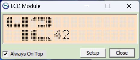

Giant numbers on alphanumeric display 2x16 (Basic Oshonsoft).
DogFlu66
Giant numbers on alphanumeric display.
Writing large numbers on a 2x16 alphanumeric display
This time I leave you a function to use large numbers on an alphanumeric screen, I hope you like it.
'Writing large numbers in alphanumeric display 2x16.
'By COS, 02/2023
'Pic Basic Compiler (PSI), v8.38, Pic16F88
'Generation of patterns
'2x3 digit proportional numbers
'Enlarges the numbers contained in the variable number.
Define CONFIG = 0x2f70
Define CONFIG2 = 0x3ffc
Define CLOCK_FREQUENCY = 8  'Oscilador a 8Mhz

Lcdinit  'Lcd withou cursor
'Initialize characters in the lcd CGRam for big numbers.
Call _IntStrNBig()
Lcdout "Patrones:"
Lcdcmdout LcdLine2Home
Lcdout 0, 1, 2, 3, 4, 5, 6, 7, 255  'Display the new characters.
WaitMs 3000
Lcdcmdout LcdClear  'Clear LCD

    While x  'Main loop
        _String = #numero  'Transform numeric variable to string type.
        Call _StrNBig(_String, 1)  'Write bit number.
        Lcdcmdout LcdLine2Pos(_StrNBig)  'Move cursor
        Lcdout #numero  'Write a number in normal size.
        numero++  'Increment then number.
        WaitMs 100
    Wend
End

Hi D,
It looks interesting, and I've copied it for a later date.
I don't have the IDE for that PIC installed, so I'll look again later. (I'm using the mid range 18 series)
I'm using Nokia phone screens at the moment (I can post link) , and hope to advance to TFT screen later.
Cheers, C
The function is compatible with any other oshonsoft compiler, you just have to reconfigure the fuses and ports.
Cheers.
It may be ok for the “Basic Compiler” versions, but not for the IDE which does not support elements like x++
i will recheck with latest version of IDE, to see if there was an update, so I may be wrong ( but my ide fails to compile the x++ type of element).
Can I ask why you do,
    Dim x As Bit
    x = 1
    While x  'Main loop
Instead of
    While 1
I'm slowly learning Oshonsoft and wonder if this is a limitation of the compiler.
Edit BTW, might have a go at converting this to C but will credit you of course.
That is true, you have to update to the latest version that allows several expressions equivalent to the C language.
x++ => x=x+1
I tried the latest version of the IDE and it does not support those constructs. There are 2 versions of Oshonsoft, the IDE with perpetual license and the Basic Compiler version that has those C types of constructs, but requires annual license renewals. Both products are current. The IDE is an older product but owner does not put new development into it, just bug fixes.
The IDE can compile as well, and does a good job at it, but developer just was not making much money at it so he launched a new version that requires annual license .
