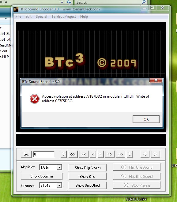

Hey Roman, just wondering if you got my email. I'll post it here as it applies to this thread:
I was just trying out your wav to digital converter program, but it didnt seem to work (im running vista) it had a error while loading a .wav file
"access violation at address 0048D9ED in module BTc.exe
Read of address 032FC508"
Thanks again :D
Ouch! I've done no testing with Vista. Most of my code in that project is very simple and using static buffers for the large data buffer (to avoid any platform specific dynamic allocation problems). It's been well tested on Win98 and WinXP.
Can you give me more info? How large was the wave file?
Nah that should be ok. Even up to 30 seconds or longer should be ok, the BTc Encoder software will only load the first 2 million samples from the wave. (edit) I just tested with a 39Mb .WAV file, it works ok it just reads the first 2 mega samples.
Sometimes on the net you will get COMRPESSED wave files, these are not compatible, but fortunately they are real rare. Just watch out that sometimes on those internet "get sound samples" type pages, a file is labeled as .WAV (or even has a .WAV externsion) but it is actually a .MP3 file or other type of file.
That can fool you because if you play the file in a popular program like Winamp it will just autoselect the right codec and play it ok, and it won't tell you the file is named wrong and is not really a .WAV file.
My BTc Program reads the .WAV header and reads the file data length as specified in the header, so if it is a funky file (not a proper8bit/16bit uncompressed .WAV) that might crash it. Please let me know if you find out any more.

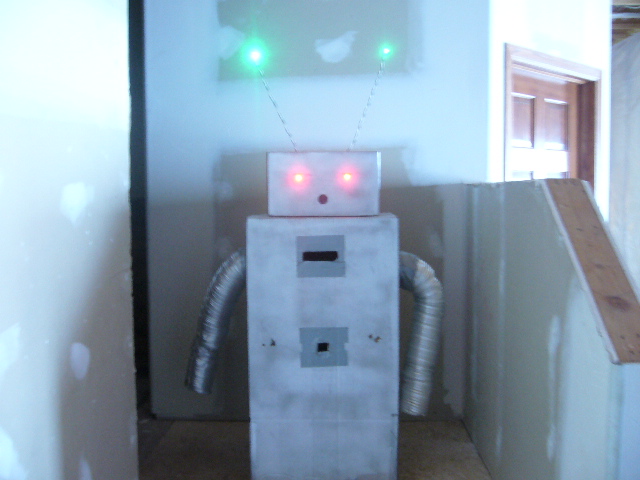

Here's a robot costume I made two years ago. I had the green LED's alternate blinking for the antennas, and two red LEDs for the eyes. I also had a voice changer that was in "Robot" mode so I had a automated kind of voice. My siblings and friends were jealous because I always got an extra handful of candy. :D I scared a bunch of kids because when I turned the volume up high it caused feedback making this scary noise. One kid dropped his halloween bag and didn't bother to get it! He just kept running! I retreated and he finally got it.

Hi all
Think I'm having the dreaded Vista blues!!
I'm getting an error whilst trying to put in WAV. files in to the encoder :( even the sample SL. files won't run.
if anyone can advise.

cracked it
Hold on!!
Fixed it, I hope!!
Open up the editor exe. via 'Run as administrator' allow the prompt then all should be ok.
I'm sure this will be the same for all Vista users.
