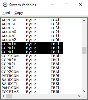

Is CCPR1= 2000 valid statement or should CCPR1H and CCPR1L be used?
jjw, if one looks at the system variables in Oshonsoft, CCPR1 is defined as a byte, location same as CCPR1L. CCPR1H is also defined as a byte, at the next higher address. Since CCPR1 is defined as a byte in Oshonsoft by default, one can only do byte operations against it and have to use CCPR1H and CCPR1L to used word values...
CCPR1 = 2000 is an invalid operation.
I checked this with PIC18 IDE.
Hi S,
I have changed the program to write 2x BYTEs, is it ok to write the 2x BYTEs in sequence timing wise? Are there any issues with this.

All the references to CCPR1 will need to be double writes so,
CCPR1 = 2000
Will need to be,
CCPR1L=0xD0
CCPR1H=0x07
And the other write to CCPR1 changed as posted previously.
edit, 2000 decimal is 0x07D0 hex.
