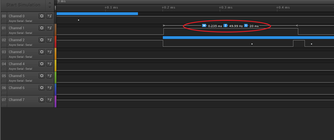

I've now got the logic analyser to work but don't understand it,
What does this mean,
The scale at the top suggests that the 0.235mS is correct but what is the 20mS and the 49.99Hz????
And how can channel 0 be the 8MHz clock, it looks more like 1.5kHz.
Hi M,
I'm learning the system too. I've speeded up my Version 1 analyser.
I've PMed new ones.

I got the email and new file but it still doesn't make any sense. It is full of "framing errors" - what are these? Is it trying to interpret it as 8 bit data?

Regarding the Framing errors, I may not have the settings correct on the analyser, but from what I can see, the timings look ok.
The analyser is showing what the program on the PIC, is outputting. To me it seems to be working.

I'm still figuring out the settings on the Analyser, or perhaps my wiring, so the Analyser stuff may show wrong Channels.

I had a go at writing some simple SW to help me understand, how the 'shift register' works in practice. It simply switches the CLK and DATA ON/OFF in a series of CODE rows.
As only 3x SERVO inputs have been wired to the analyser, I only see 3.
I wired a SERVO to CH1 and it is working fine, considering it's SW, but there's nothing else INTERFERRING with it, so understandable, and only a test.
The CLK tic is only for a few uS, as has been explained, but seeing is believing :)
Here is the analyser view.
EDIT: I was glad to see the HW PINs are working.
C
That is very promising and proves that the hardware is as expected.
Can you post the code that produced that?
