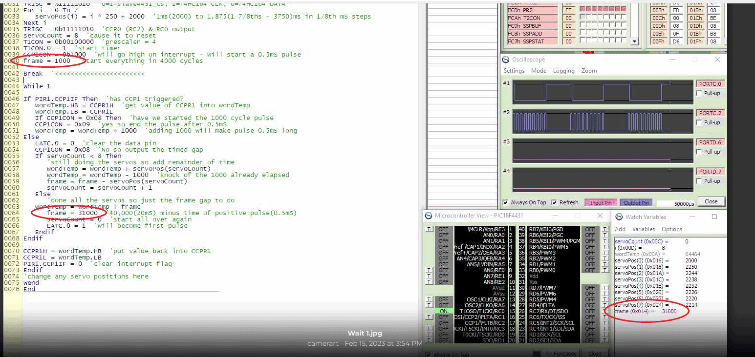

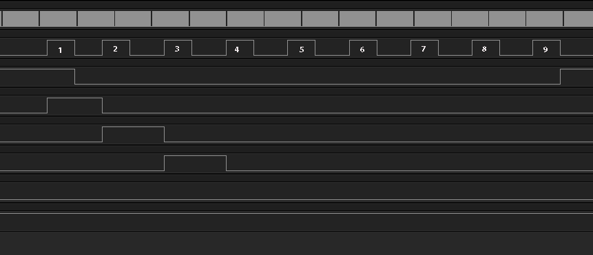

I've got the new file and can look at it,
it has 9 positive pulses of 0.5mS which is correct - 8 for the servos and a ninth for the gap.
However, the off time should be the servo time less 0.5mS.
The first one is correct at 500uS giving a total time of 1mS.
The second one is correct at 625uS giving a total time of 1.125mS.
After this they're all wrong, I don't know why.
Can you place a breakpoint just before the while 1 line and confirm that servoPos contains 2000,2250,2500 all the way up to 3750?

Hi M,
It only Breaks at 76:75, then keeps running.
I imagine that in the MAIN_LOOP there would be a way for me to change servoPos times, like this:
C main: '\/\/\/\/\/\/\/\/\/\/\/\/\/\/\/\/\/\/\/\\/\/\/\/\/\/\/\/\/\/\/\/\/\/\/\/\/ servoPos (0) = 1000 'servoPos ON time, this will change once control is added servoPos (1) = 1000 servoPos (2) = 1000 servoPos (3) = 1000 servoPos (4) = 1000 servoPos (5) = 1000 servoPos (6) = 1000 servoPos (7) = 1000 frame = frame - servoPos (0) 'Subtract each servoPos time from Total time frame = frame - servoPos (1) frame = frame - servoPos (2) frame = frame - servoPos (3) frame = frame - servoPos (4) frame = frame - servoPos (5) frame = frame - servoPos (6) frame = frame - servoPos (7) 'For i = 0 To 8 'servopos(i) = i * 1000 + 8000 '1ms(8000) to 1.875(7/8ths - 15000)ms in 1/8th mS steps 'Next i

Something is very wrong, servoPos is correct for the first two values and then completely wrong. For example, servoPos(7) should be 7*250+2000 which is 3750 but it's got 2214 in it - how is this possible?
Also, frame should contain 1000 but has 31000 in it which suggests it's executed the code at least once,
The (only) good news is the logic output agrees with the values in servoPos.
This is done automatically by the line,
frame=frame-servoPos(servoCount)
and, The servo time is now a factor of four different so 2000 is 1mS before, 8000 was 1mS. Hence the changed values in the for loop that sets up servoPos.
Note, servoPos(0)=1000 will not work, this is setting servo time to 0.5mS - minimum value is 2000 which is 1mS.

I asked this before, but will there be a LOOP for the RC program? In the LOOP, the will be SPI inputs from the other PIC on the PCB, and CODE to deal with calculations etc, where the SERVOPOS's will be changed.
Re: The 'It only BREAKS at 76:75, then keeps running' line!
I don't know when the BREAK is expected to 'fire' but it only 'fires' once at 76.75 us.

It should only execute that Break instruction once as it's outside the while loop and frame should equal 1000 but it doesn't!!!! How is this even possible? I'm rapidly loosing faith in Oshonsoft.
Lots of code can be added as long as it's not blocking code (no pauses etc.).
But first, this needs to work. Can we try and get the break to work?

What actually should the BREAK do? Should it BREAk each 20ms?
To clarify: Does the CODE jump in and out of the WHILE/WEND loop?
C
As I said, it's outside the while loop so should only be executed once before any of the while code is executed and therefore frame should contain 1000 as that instruction is directly before the break.
I can't understand HOW the break gets executed after the loop has been executed (indicated by frame containing 31,000).

I'm a bit puzzled why you set SERVOPOS with a calculation, when it will be set by other inputs. The #486 shows my fixed settings for testing, don't you think this would be better?
C.
Have you read my replies? As I stated, 1000 WILL NOT WORK. As explained above.
The only place servoPos is written is in the for loop and should contain values between 2000 and 3750. How can other values be in there?
