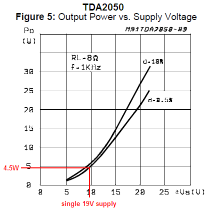

Don't guess at the numbers, look at the graphs on the datasheet.
The TDA2050 has an output of 4.5W into 8 ohms with a 19V supply or maybe (at the very bottom of the graph) only 2.5W into a 4 ohm speaker with a 13V supply.
A TDA2005 or TDA7240A produces 13W into 4 ohms with a 13V supply.
My car has some 2 ohm speakers for nearly 25W each with a 13V supply.
When you turn up the volume higher than the max voltage swing possible with your supply voltage then the amp clips the signal and it is distorted.
