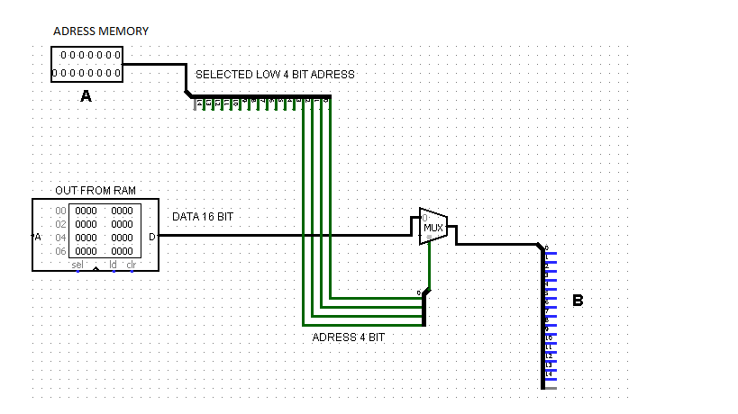

i build like i understand you a 16 way MUX, so i did like you say
sorry what come next to circuit i build
something to adress memor spmething to output mux
where the dual - RAM where to connecte to adress memory or out from mux, and generatoroutput from mux or adress memory
please help to build this circuits(we are almost finish;--)

You are a VERY long way from finished!
You would need to build the whole clock generator, sync timing and column / row counter system, just to start with.

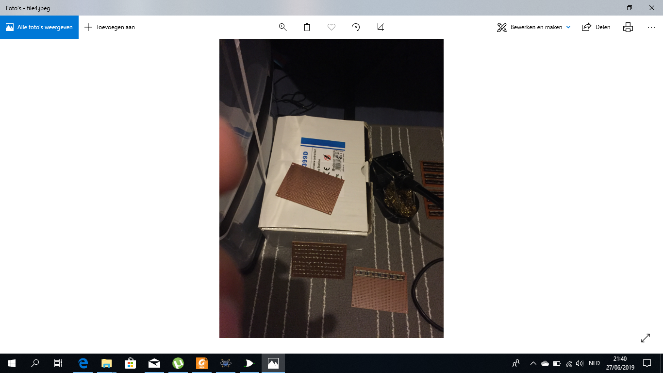

You still have not posted any photo of actual _physical_ builds of parts, that you earlier said you had breadboarded.

i (hope) will put the photo tomorow… because of time

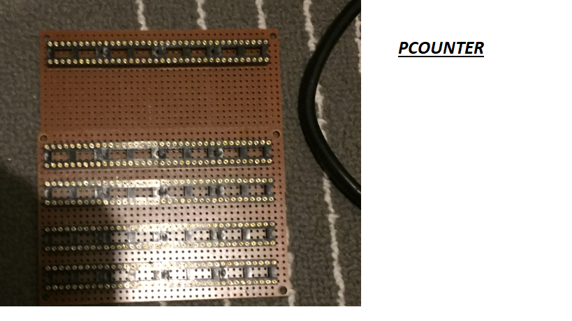

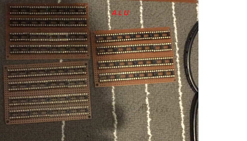

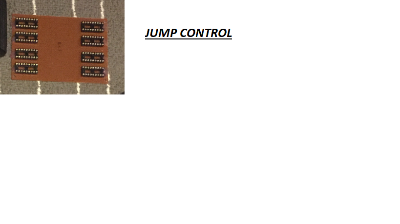

here what i work
i am gonna make your circuit for display controller ;-)))) he goona work for my processor?(
i try to understand and to build, when i gonna build i gonna send you email right ) ohh Goodnight.....
Your circuit is a few boards full of empty sockets?
You need spaces between the sockets - some IC bodies are too long to fit with the pins. Gaps are also useful as wiring "lanes" so the connections you add are not crossing other solder joints - or places you will need to add more connections to later.
Also you have all 18 pin 0.3" pitch, no allowing for the different size ICs.
You need to fully plan things and work out the exact IC types (and packages), plus allowing for other components, before you start building.
This is a practical example, though built with wire-wrap. There are decoupling capacitors under every IC, hidden inside the IC sockets.
The ICs are set out with reasonable spacing, on a ground-plane board to avoid electrical noise.
