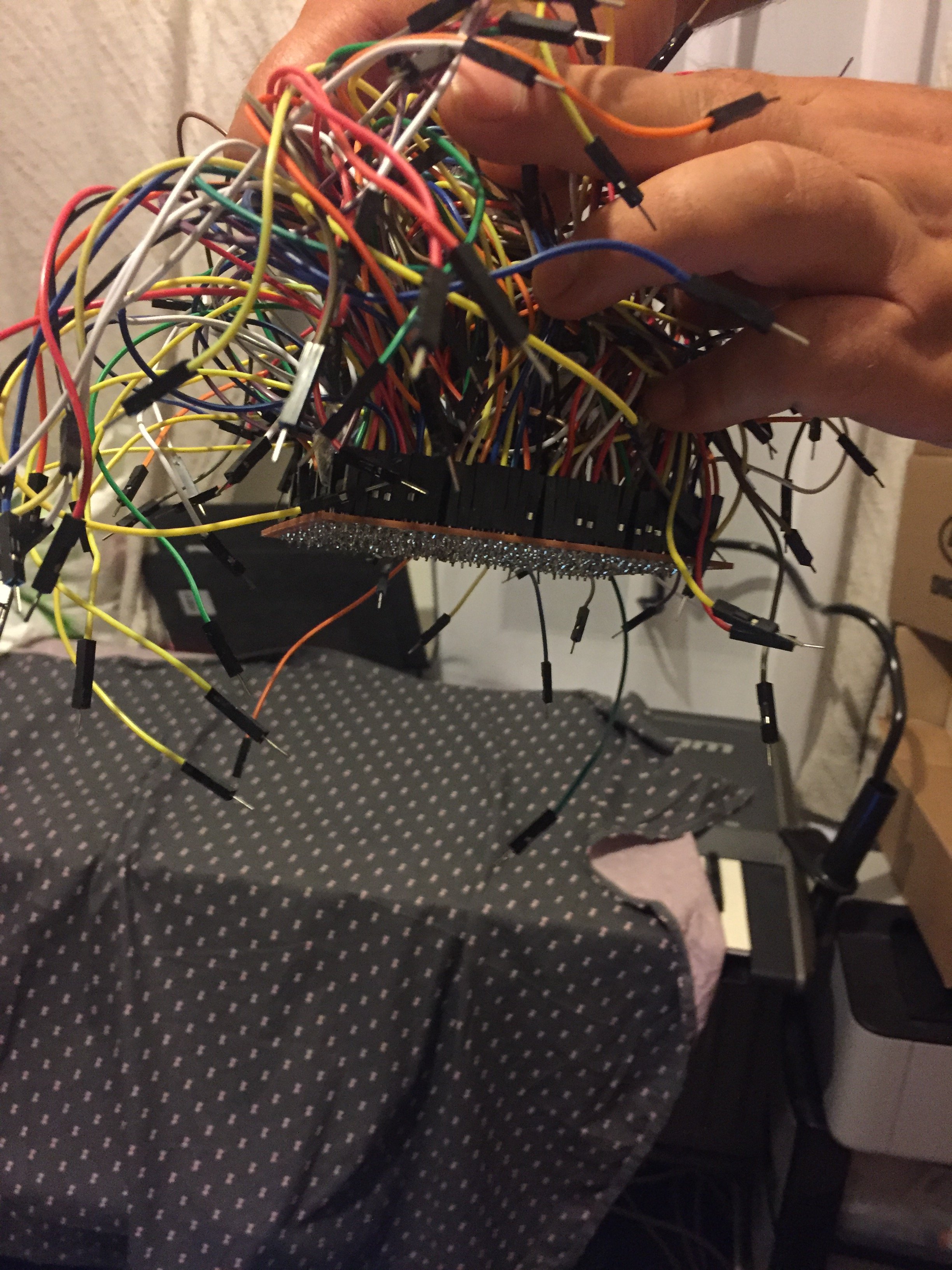

Hello, please can somebody help me this circuits cpu to connect with display and keyboard
Your circuit is a few boards full of empty sockets?
Hello Gophert, like i told you before...i say with my self(why i have to make, when i dont know for screen and i stop working i thought there is complete(man i did not know), but now i know...is PERFECT from the next(hope) i gonna start to finish ;-)))))
Have a Nice Wekend.... greetings
You need spaces between the sockets - some IC bodies are too long to fit with the pins. Gaps are also useful as wiring "lanes" so the connections you add are not crossing other solder joints - or places you will need to add more connections to later.
Also you have all 18 pin 0.3" pitch, no allowing for the different size ICs.
You need to fully plan things and work out the exact IC types (and packages), plus allowing for other components, before you start building.
This is a practical example, though built with wire-wrap. There are decoupling capacitors under every IC, hidden inside the IC sockets.
The ICs are set out with reasonable spacing, on a ground-plane board to avoid electrical noise.

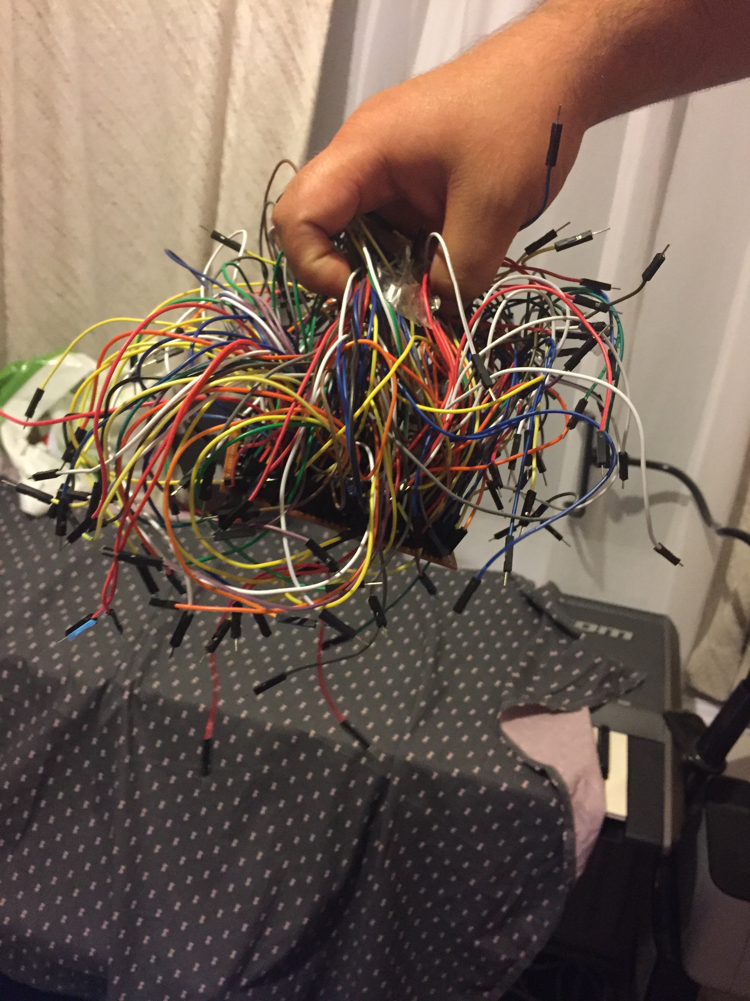

yes i did it, i goona show you.... and next what to do?
How about showing us what you've done so far (photos) and then we can help you better.
Hello Gophert
here one piece of alu there almost 256 wires
