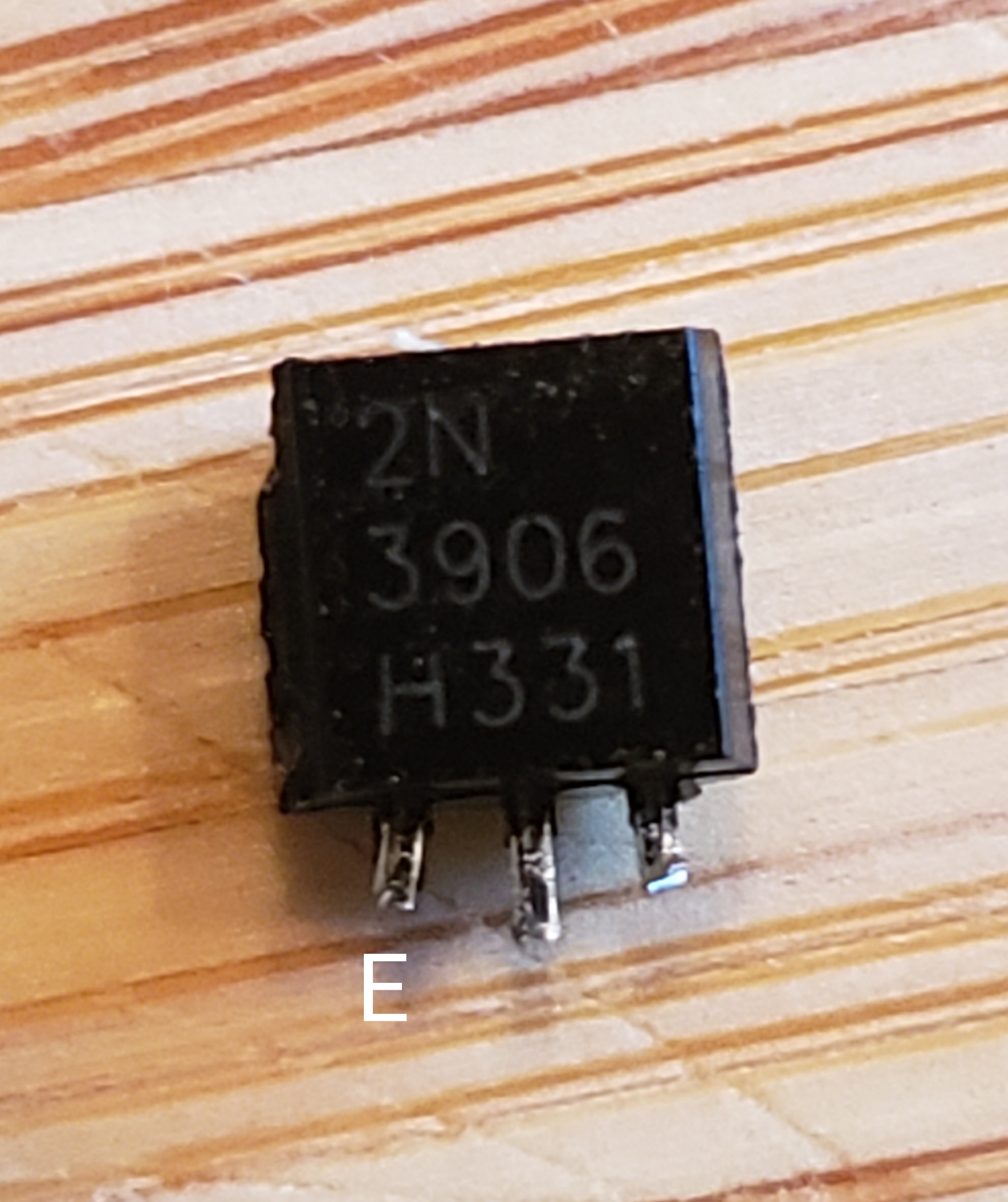

Is it possible I have my transistors in backwards? Images like this confuse me so maybe there's an orientation problem.
View attachment 134646View attachment 134645
Transistor pinouts are all over the place. You need the correct datasheet from the manufacturer of the exact part you have.
ak
I understand. I dont have a manufacturer. But I got this super close up image. I think Q3 is backwards. Could you help me verify?
Let's say that pin 1 here is the emitter on the 3906. While Q2 points correctly it looks like Q3 is in upside down.
