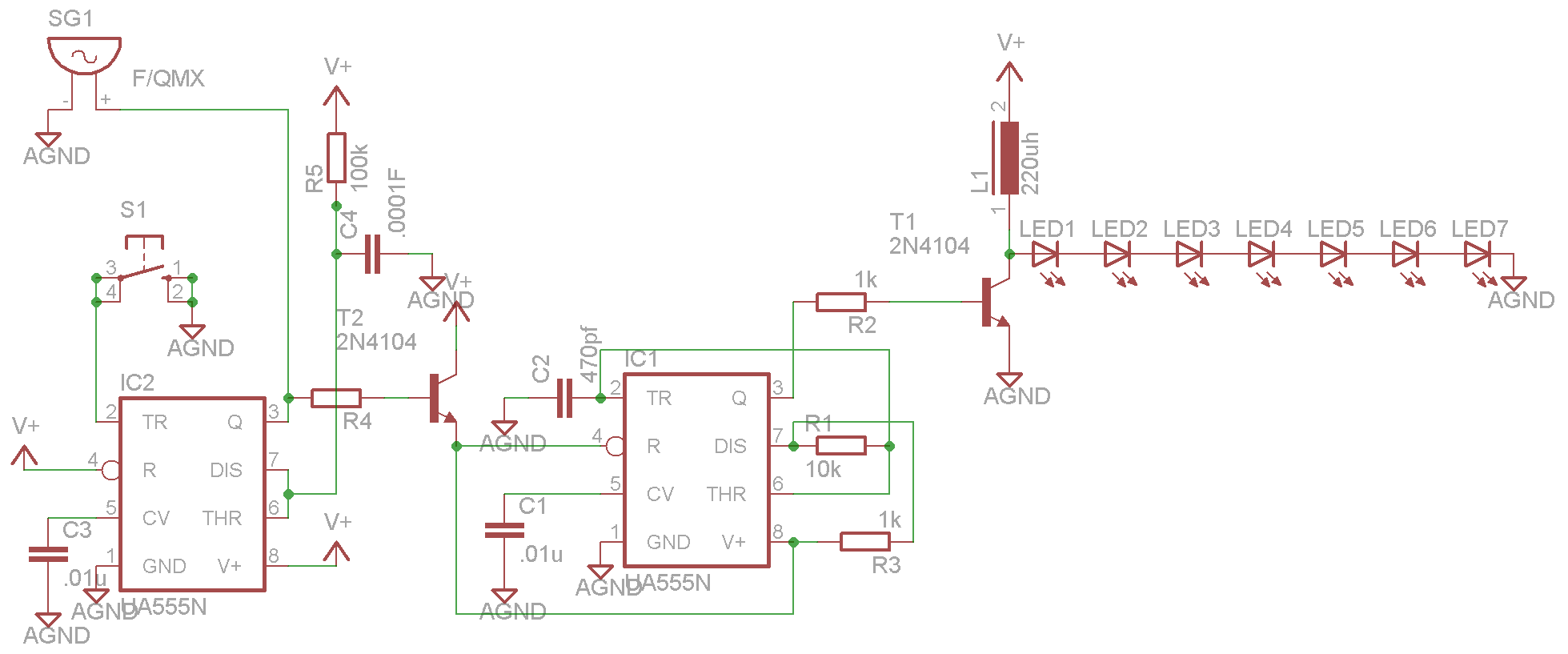

Here is a quick diagram i drew (wont work i dont think) but its to try and explain how it works.

Can you treat me as a complete novice on this and explain that diagram a little more (i can read 90% of it but what is the IC1 and IC2 (HA555N) as google search and searching rs comoponents brings up nothing.

Activation of the switch (S1) will then activate IC2, this delays the activation of IC1 which then delays the time constant to fire the L1 capacitor linked to the LED's.
While this is happening, IC2 fires SG1 (Buzzer??) before the 2nd timer unit?
Am i right in this so far. If so, can the buzzer and LED's be fired simultaniously and not at different times.
The timers, the time it delays the time by is done by varying the resistors with **broken link removed** this formula?
the ic2 is wired as a multi vibrator
the supply for it to work is given by 1st 555
when the output goes high for ic 1, it will trigger both the next ic and the buzzer too.
the inductor acts like a power booster.
the correct expression is given here (for mono stable which provide the delay)

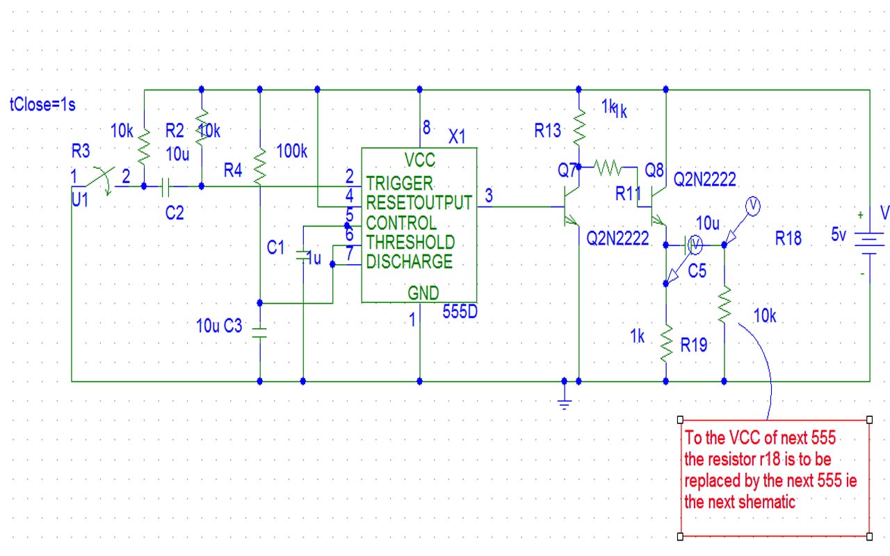

The monostable multivibrator, shown here will provide the time delay as you press the switch,
the out put wave form will be:

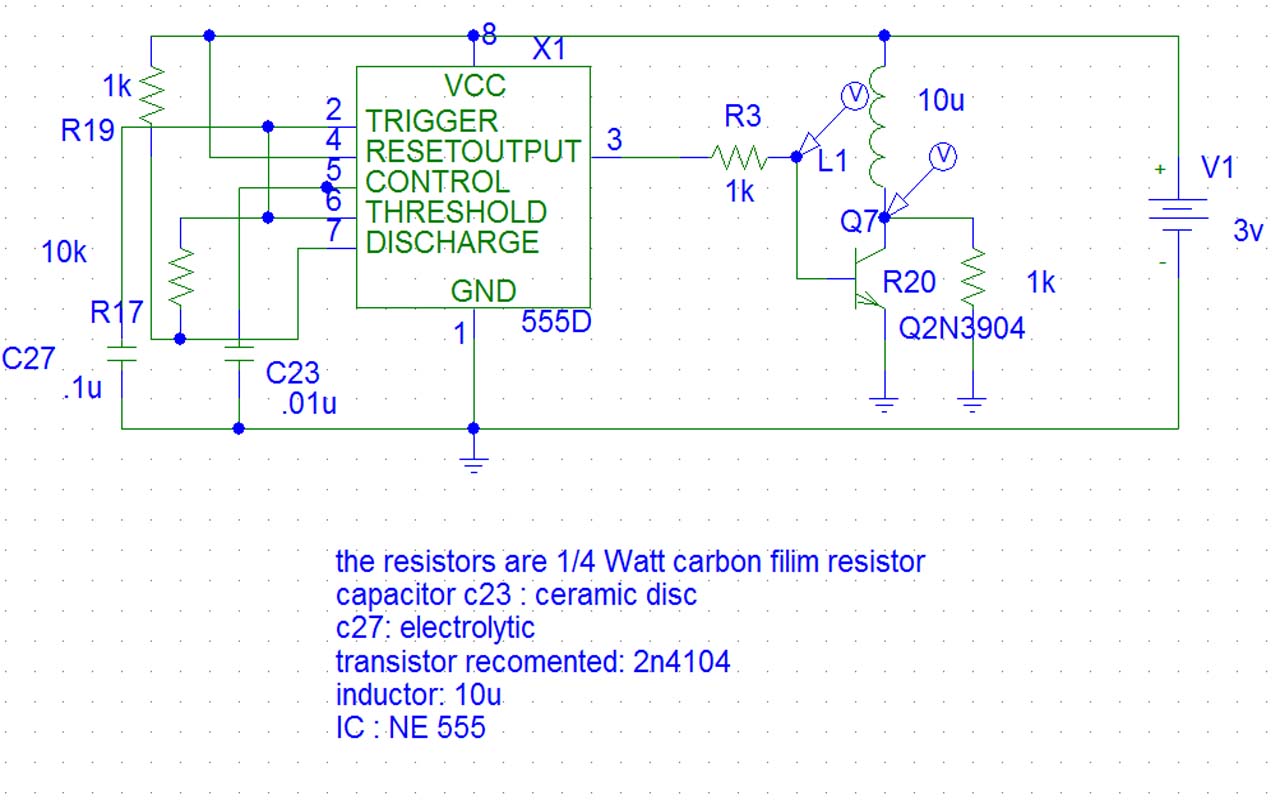

this is wires to the astable multi-vibrator which drives the LED flash.
View attachment 55d.pdf
the complete circuit will be:
LED used is high bright white LEDS

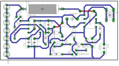

this is the PCB
View attachment untitled.brd.pdf
pcb top

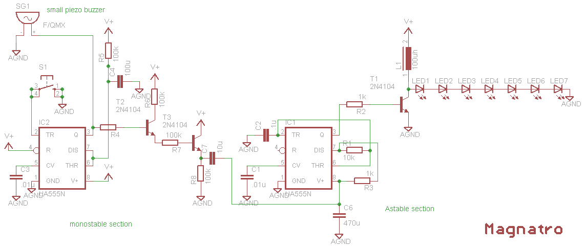

Magnatro, in your schematic of post 6:
- There is no purpose of inductor L1? For a brief pulse of light, the inductor would limit the rise time - surely the flash would be better without it. Adding a capacitor might be a better option if your battery cannot provide a big pulse.
- Pin 3 of the first 555 timer should connect to pin 4 of the other, with 8 on both going to V+. This is the correct way to link two 555s - pin 4 is the reset. Your method is overly complex - also T2 would need to be a PNP transistor for it to work.
- Pin 2 of the first 555 timer needs a pullup (10K should do) to V+.
- The LEDs at the output should be in parallel, and each MUST have a protective resistor. Wired in series, they would not light (especially white LEDs, with a high Vf).
In the schematic in post 16:
- The same issue with the inductor.
- Pin 4 of the second 555 must be high for it to work - the best way to do this is connect it straight to pin 3 of the first, then connect pin 8 of the second to V+. With pin4 floating, the circuit won't work.
- Pin 2 still needs a pullup
- A piezo is the wrong component for SG1 - you need a buzzer (with a driver built in). A piezo would make no sound.
- C7 will stop any DC current getting to the second 555 - it will stop the circuit working.
- Your T2/T3 wiring is wrong (and some NPN/PNP confusion), but they are not needed anyway.
- The same issue with the LEDs and lack of resistors - in your circuit, they would not light up.
