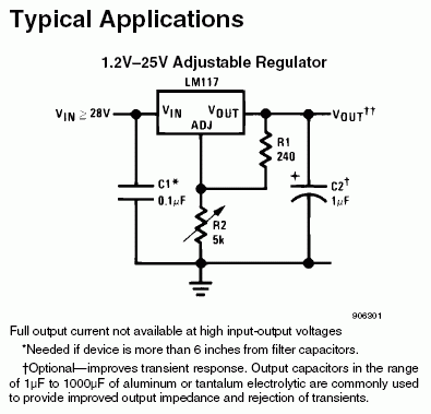

LM317 in the TO220 package mounted on a good sized heat sink. R1 is 240Ω. Make R2 a 500Ω or a 1000Ω pot.

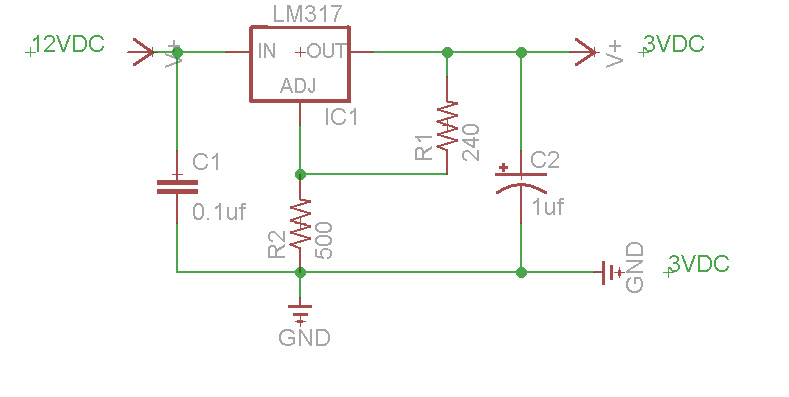

Is this right?
Make R2 a pot so you can set the running speed of the motor. If R1 is 240Ω, the formula for calculating R2 = 192 * Vo - 240 , so if you want 3V, R2 = 192 * 3 -240 = 336Ω. A 500Ω pot will adjust the voltage from 1.25V (the minimum) to 3.65V. A 1000Ω pot will adjust the voltage from 1.25V to 6.46V.
