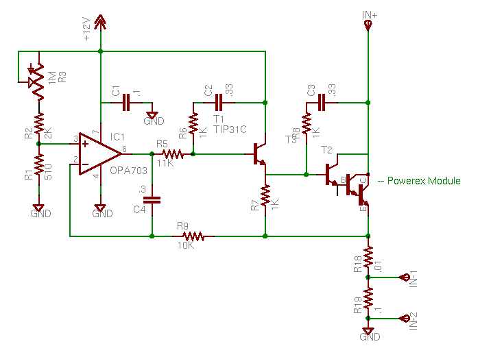

So I'd like to use a single 10 turn pot for adjustment. Slim pickins for a 1M precision pot it seems. If I change it back to 100K I need to go with a lower reference voltage right?
Sorry, but I don't remember seeing a 1Meg pot in any of your schematics. Can you post what you have now?
I changed the 100k pot to 1Meg when I changed the reference method. Here is a current schematic.

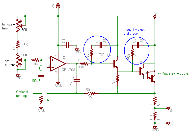

I would do it like this. You can scale the pots up by as much as 20 times (10k each), or anywhere in between, so long as you scale R2 proportionally. This way, you can use any value that you can find.
The full scale trim is a set and forget. One turn should be sufficient.

Oh cool, I'll do that. R6,8 and C2,3 are for stability (at least that's what I was told in one of the articles I read). Are they not needed?
Oh, ok. I missed the part about C4,R9 being replacements for those compnents.
I can't guarantee that my solution is better than what you were using, because (1) I don't have a model of your power module, and (2) I wouldn't trust it if I did.:(
