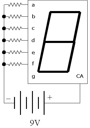

The next thing is to determine the current limiting resistors for the displays.
I used this formula to calculate the following resistors. Vcc=9V Vf=2.5
and If = 3.33Ma and If = 10Ma.
R=(Vcc-Vf)/If. The closest standard values are 2.0k and 680 ohms.
This test will determine the drive circuit for the displays. My circuit as it stands will drive 20 Ma. It is possible that the displays will be bright enough with only 3 Ma per segement, but if not then the 10 Ma per segment should be adequate as per the spec sheet.
What you need to do is get 6 ea 2K ohm and 6 ea 680 ohm 1/4 watt resistors and connect up one display to a 9V battery as shown on the attached schematic. Then tell me if the 2.0k resistors are okey or you need to use the 680 ohm resistors.
I've done the test for the display with two values of resistors. 680 ohm resistors are suitable for my 7-segment LED display.
