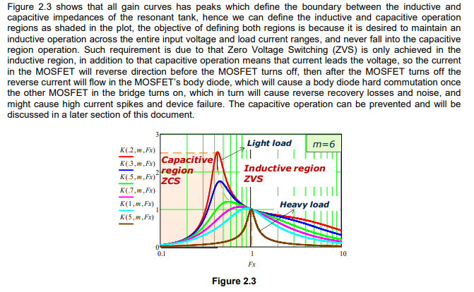

Thanks for that article...i am not sure about that doc...because on 6th page (marked pg 5), they say....
(regarding operation above the resonant frequency)....
QUOTE.....
**The rectifier diodes are not softly commutated and reverse recovery losses exist**
...this is completely wrong....and is a basic situation of the LLC converter.
And it is in fact, common to operate an LLC above f(res), because you are further from the capacitive region....and your RMS and peak output current is lower.....
I must admit it was a surprise to see such a generally excellent article about LLC converters getting the most basic aspect of them totally and utterly wrong.
Contact TI, I am sure they would want to revise the app note.
I am reading an Infineon ap note, as I am new to LLC, and they clearly state -
Regards, Dana.
