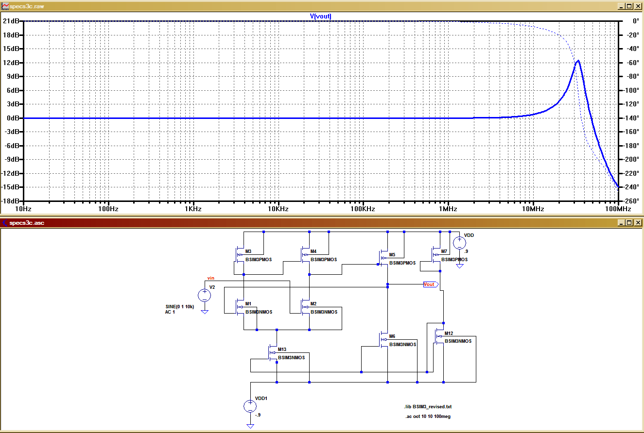

This is the AC analysis with +/-0.9v, with a 1Vsignal and 0V offset.
Is this what you are asking.???

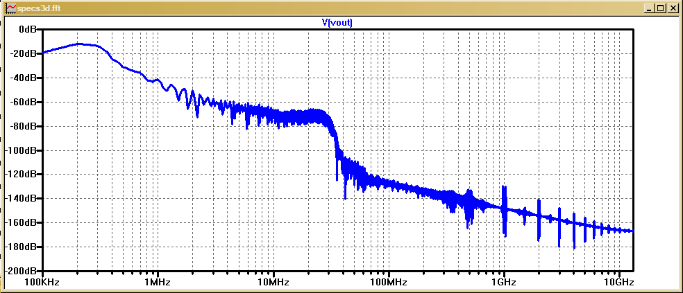

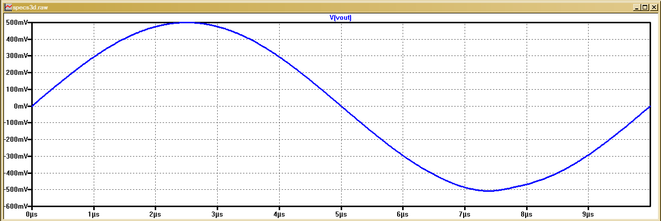

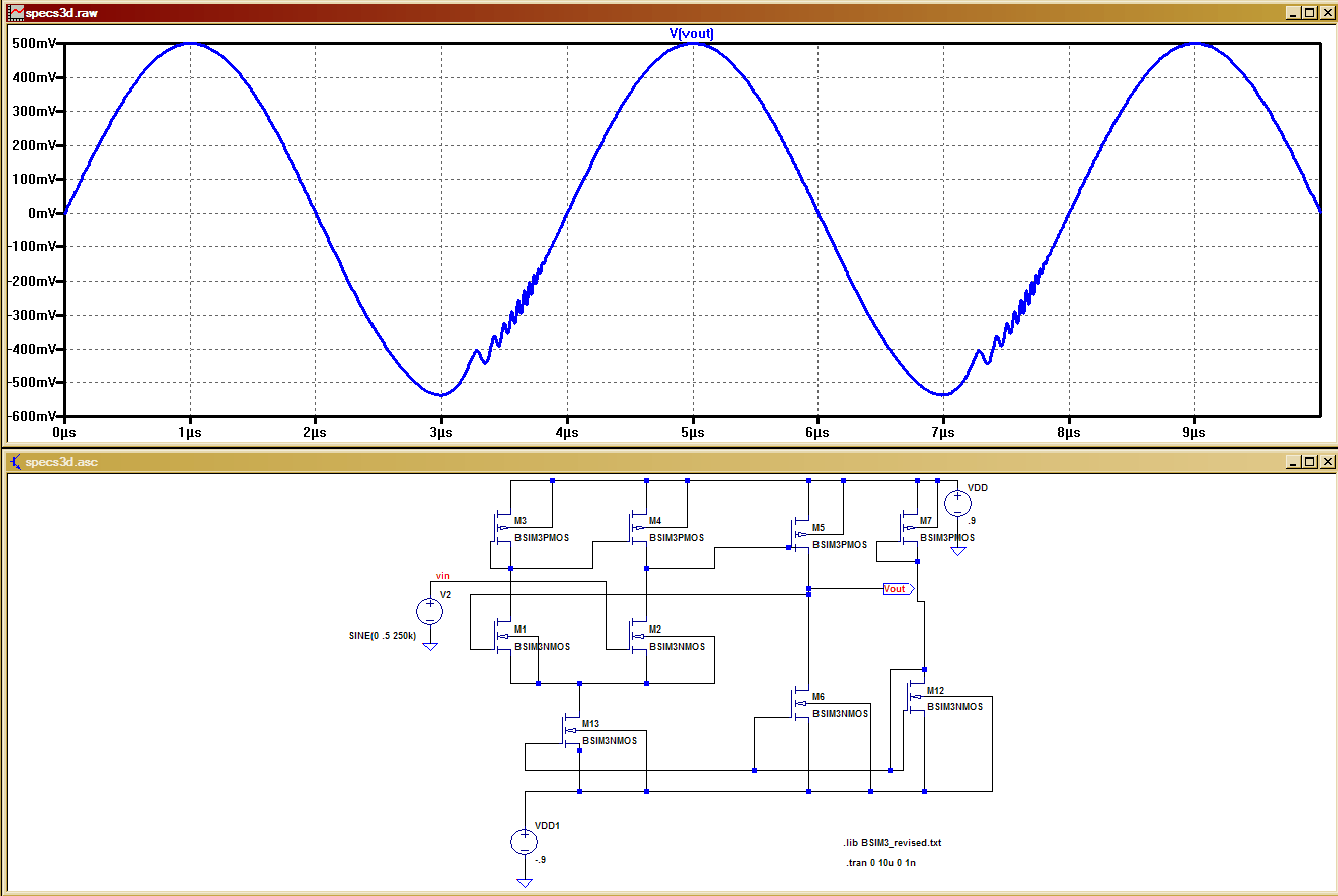

The plot you posted has the Time Scale obscured, cannot see it, so I have assumed a 500KHz 1Vppk Sine wave input.
As you can see there is some instability in the amp, I have also attached the FFT
EDIT:
Using a 100KHz sine wave input, gives image #3, which matches your 'doc' file plot

Hi Eric
That is the one I am looking for. Thank you so much. Sorry, I did not reply yesterday.
I had lesson and checked with my friends too. I have one few initial mistakes in my first circuit.
Thank you

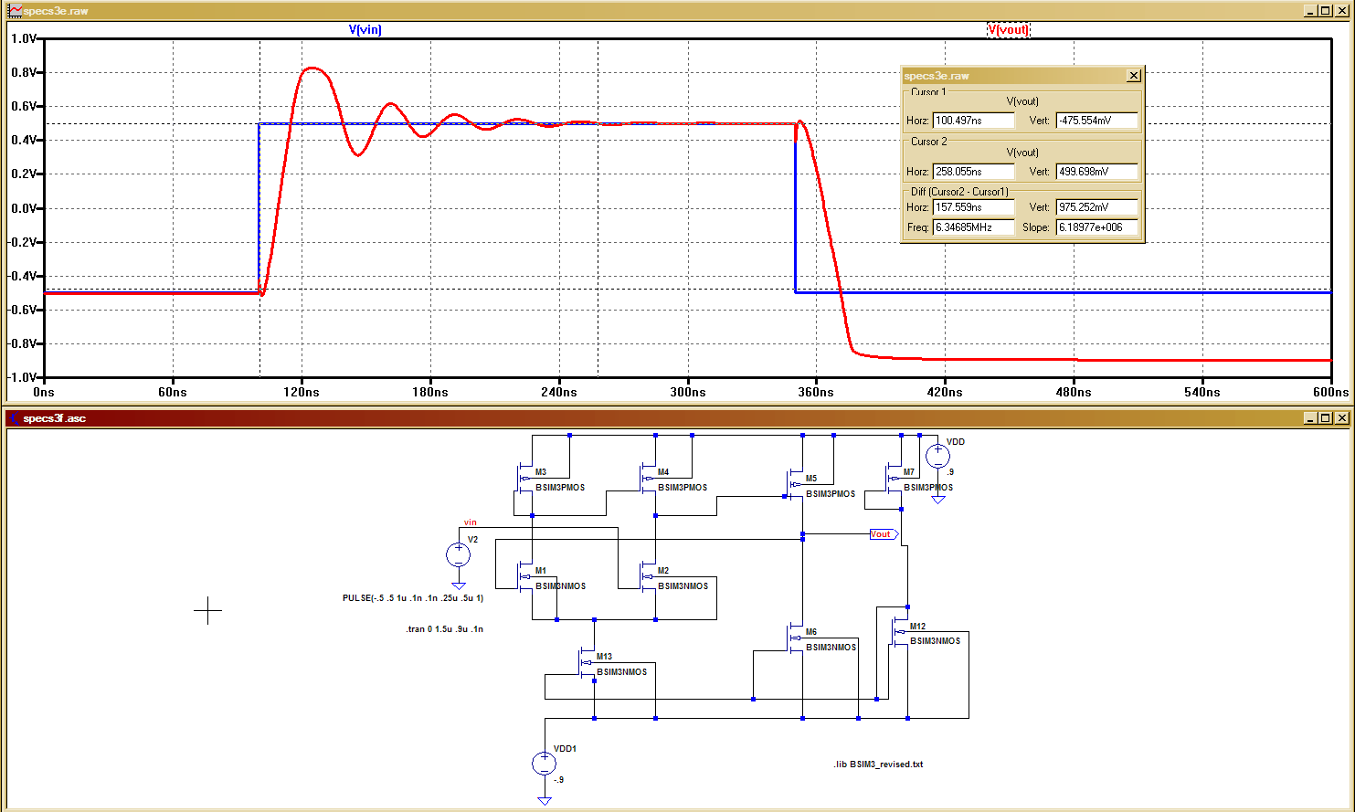

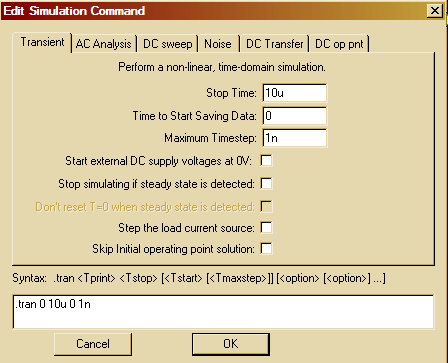

I need one more help. Could you teach me how to set up for “transient response of voltage follower?
Kindly see the attaché doc file for reference.

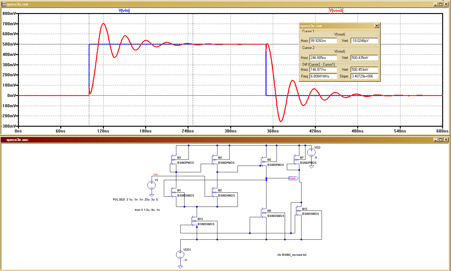

I should find 1% settling time, (t)settle for a volt step <500ns
Thank you

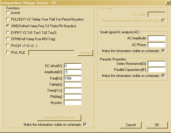

If you mean the LTS settings for the Transient Response plot I posted, look at these images.
I will look at the response for a 1V step voltage, let you know.
Two transient pulse plots, using a 0.5V step and the other using -0.5v to +0.5v input step.
I have used the 'double cursor' option to show a 'rough' measurement of the over/under shoot decay time.
  • specs3e.asc
  • specs3f.asc
Wow :) Amazing. Thank you thank you.
