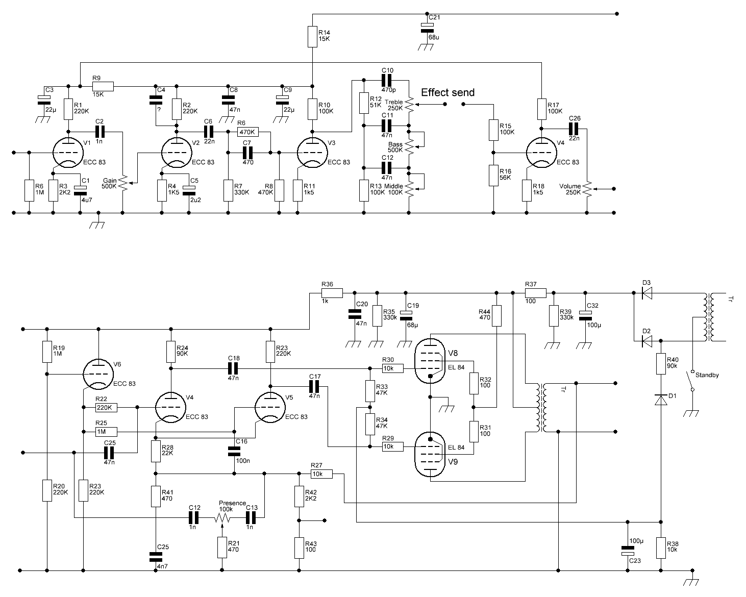

Hiwatt custom 20 tube amp hum problem
Don't worry about little goofs I can spot them quick
and fix them after in the computer and post it.
C2 is actually C3
and C2 is C3.
C3 has a value of 102.
R6 should be R1
R2 should be R4
R4 should be R5
I think that's right.

I think the tone stack might be based on this:
What do you think?
I just don't have the skill or knowledge to draw it out.
I hope you can complete the schematic,
you'd be giving me a great Christmas present!:)

OK, have a try with this, it's the full circuit now.
I'd change the following caps, C32, C19 and C23..... for starters
and maybe C21 for good measure :D
Nigel, you're my hero!:D
A magnificent job and a wonderful christmas present!
I appreciate your work tremendously!
I wish I had the knowledge.
Sounds like some of the guys I showed it to don't have the knowledge either:)
If they can't figure it out now, with the great work you did,well I'm thinking maybe I can send you the chassis. I'll see what happens this week.

If the hum is something you never had before and now you have it and it gets louder and louder as you turn up the volume the problem is a bad electrolitic capacitor in the power supply.
If the hum is something you have always had and something you would like to get rid of then the filter capacitors in the power supply may not be large enough to filter out all the AC pulses in the DC. You want flat line DC.
Check C32 and C19
See my post further back.......:(
Check C32 and C19
I thought the problem hum was mostly 60 hz? Full wave rectifiers have 120 hertz hum as their main harmonic. Half wave produce the 60 hertz hum. Am I thinking right on this?
Yes, trouble is the supply rail is so high that scoping isnt practical due to the input voltage limitations of the Y amp, although using an attenuator may help...
If it were me, I'd just change all the components in the power supply section as there arent that many...2 diodes and a couple of caps?
If the reservoir caps have dried out or are under capacity then this would have an adverse effect on the performance of the amp...easily remedied..
Presumably you don't have a scope?, and aren't used to using one? - there are no problems whatsoever in scoping the supply in that valve amp, and presumably that's already long since been done?.
Yup, I have a scope, in fact three....What threw me was the comment made earlier...
Okay, the tubes and caps and resistors are all good.
Tube 4 has a bit too high voltage 350 instead of 285.
Although I'm not too sure what the max input voltage to the Y amp is on any of them...
That being the case, scoping the HT rail should have been one of the first checks, I would have thought...?
