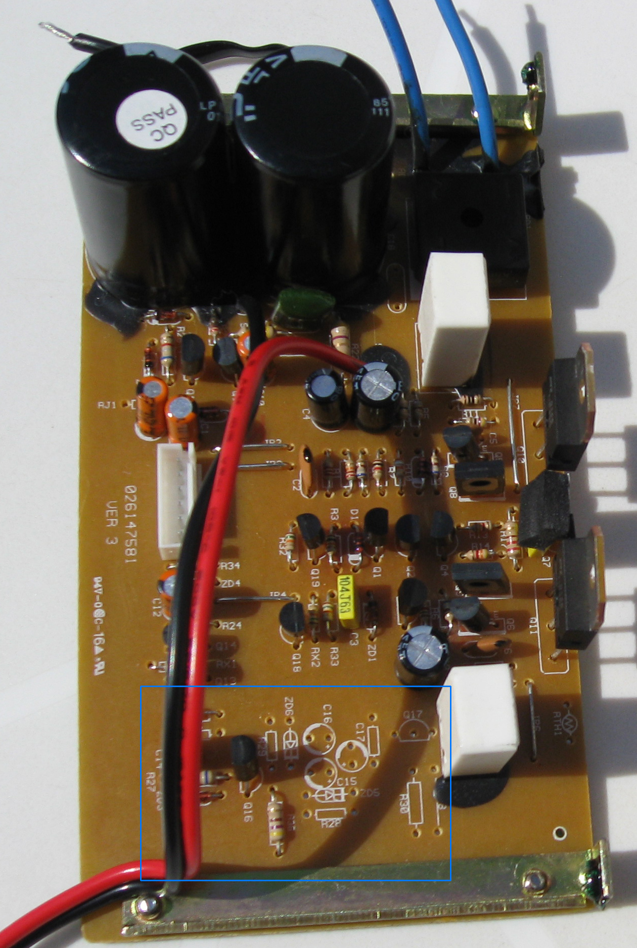

C16 is inexistant on this board. The PCB has a place for it, but as the picture attached shows (old picture, been some cap changes etc since !), there is room for it, along with C15,17 R28, ZD5 etc, but no components there. I wonder what happens if I "add" those bits in !

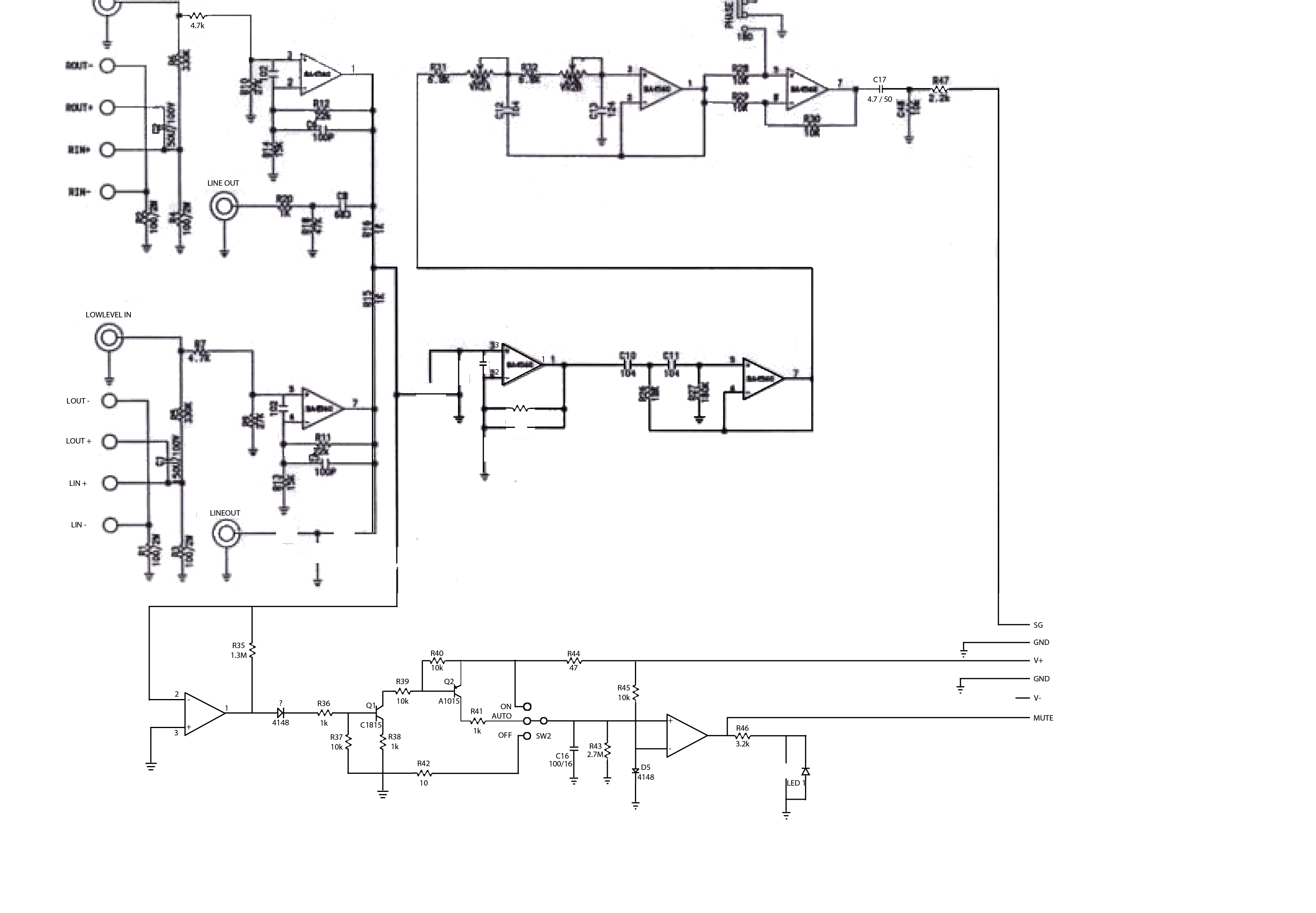

The components your talking about, I can't read the type designations on page 1 of the schematic so you'll have to describe their locations by describing where on the schematic page they are located or make a page and circle them. You can use the free program www.irfanview.con and convert the page to .jpg and then use MS Paint to annotate. IRfanview requires the downloadable plug-in set to open PDF's.
I can't read the part numbers on the 1st sheet so here goes.
Find the center terminal of the switch.
Locate the 100 uf and large value resistor (2.x m-ohm) off of that terminal.
What is the OP amp type # that it's connected too?
The voltage across the parallel combination is what I'm after; call it Vdelay.
There is a 1n4148 diode nearby. What is the voltage across it (Vdiode-ref) with or without sound?

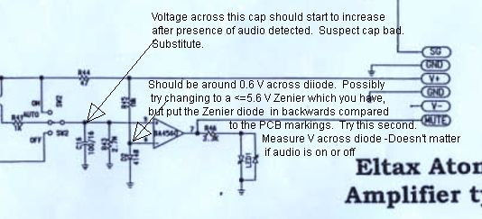

OK.
Test #1
Check voltage across diode. Power on. Sound doesn't matter. If zero, check diode. I would not use a 1n4148 here. Voltage should be between about 0.4 and 0.6 volts.
Test #2.
Place sub in auto mode.
Apply sound. Note delay when LED changes color. Delay should not be zero.
test #3
Look at the voltage across the cap, as you apply audio. Use a fixed voltage scale on your meter, not auto-range.
Look at this voltage when you apply music. It should steadily increase.
You might try temporarily substituting the 100 uf cap, since you can't measure it if the diode has a decent voltage across it.
Since you have a spare ZD5 (5.6V), you could also try replacing the 1n4148 with 5.6 V Zener, but reverse the polarity. You would then have 5.6 V across this diode instead of 0.4 to 0.6 which should increase the delay.

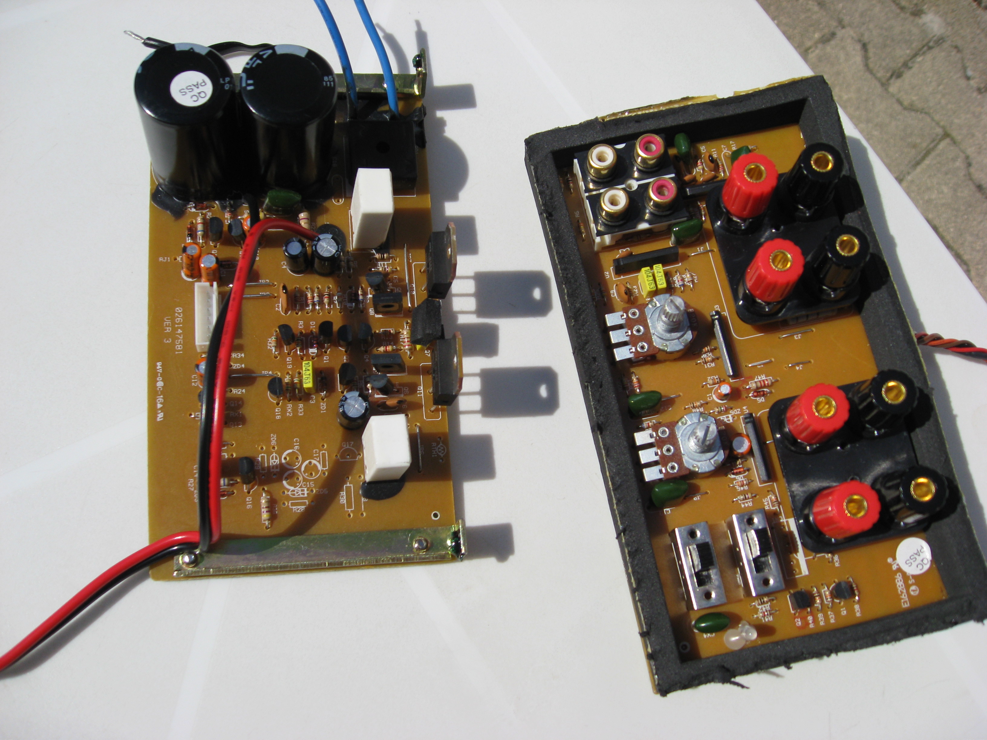

I was referring to the missing components on the first PCB, the one we have been working on until now. I cropped the picture and circled the "missing" C16 etc, see attachment.
This is on the second PCB, with the inputs/outputs, pots etc? Not sure what you are referring to here, I'll keep thinking about that.
Test #2.
This is one thing I can already comment on - there is NO delay when the LED switches colour on auto mode...
Could we be looking at something else bust on the second PCB?

3.2 The thump doesn't occur (or possibly is diminished) when a source is plugged in, playing music, and I do the same routine (amp forced on ON mode and I hit the AC power switch).
4. I still have a small hum going through to the speaker when it's on, I assume this is because the output voltage (with no source plugged in) is still around 0.080 - 0.090V, not great... I also wonder how I could possibly decrease this, although fixing the other issues might be of greater importance !
I've changed quite a few bits of this PCB, going to make notes of what I have and haven't changed so far... Have been learning a hell of a lot, got loads of fancy tools, improved my soldering considerably (25W soldering iron really helped, my old 15W was a real nightmare), but I'm still stuck with the original problem + the one I created shorting things out !
Could it be possible the other PCB is responsible? I'll let you know what I haven't changed on PCB1 !

If you look at the preamp/control board. Lower right hand corner. Follow to the left the MUTE signal.
MUTE goes to the LED and Pin 7 of the OP amp.
Locate the input of the OP amp:
1. Now the diode (1n4148) and series resistor (unknown value and designation)
2. Locate the 100uf cap and the 2.x M resistor
That's the area I want to go next. Keep Q7 (E-C) shorted. Ket a 3.3K and 500 ohm variable resistor (10 Turn trimmer preferred)
Try this pic to make things a bit easier to understand.
The voltage should increase across the capacitor starting when audio is detected. Use
You meter on a fixed range. Don't autorange. You have a 100 uf cap to substitute here
because you can't test it with your meter.
When the voltage reaches the reference of the 1n4148 diode ( a diode drop), the LED should turn on. We can increase the diode drop and thus increase the delay. You have a 5.6 V diode, but it has to be turned around to provide 5.6 V. Otherwise it would provide 0.6 V or a standard diode drop.
Verstehen Sie?
Verstehen Sie?
