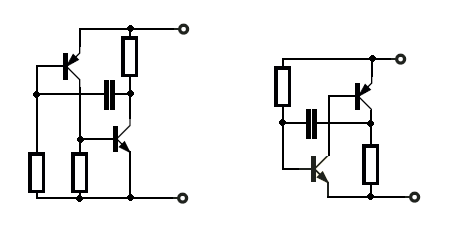

Circuit show by MrAl is a classics multivibrator circuit plus "boost converter" (more or less) to light the LED from low AA cell.
