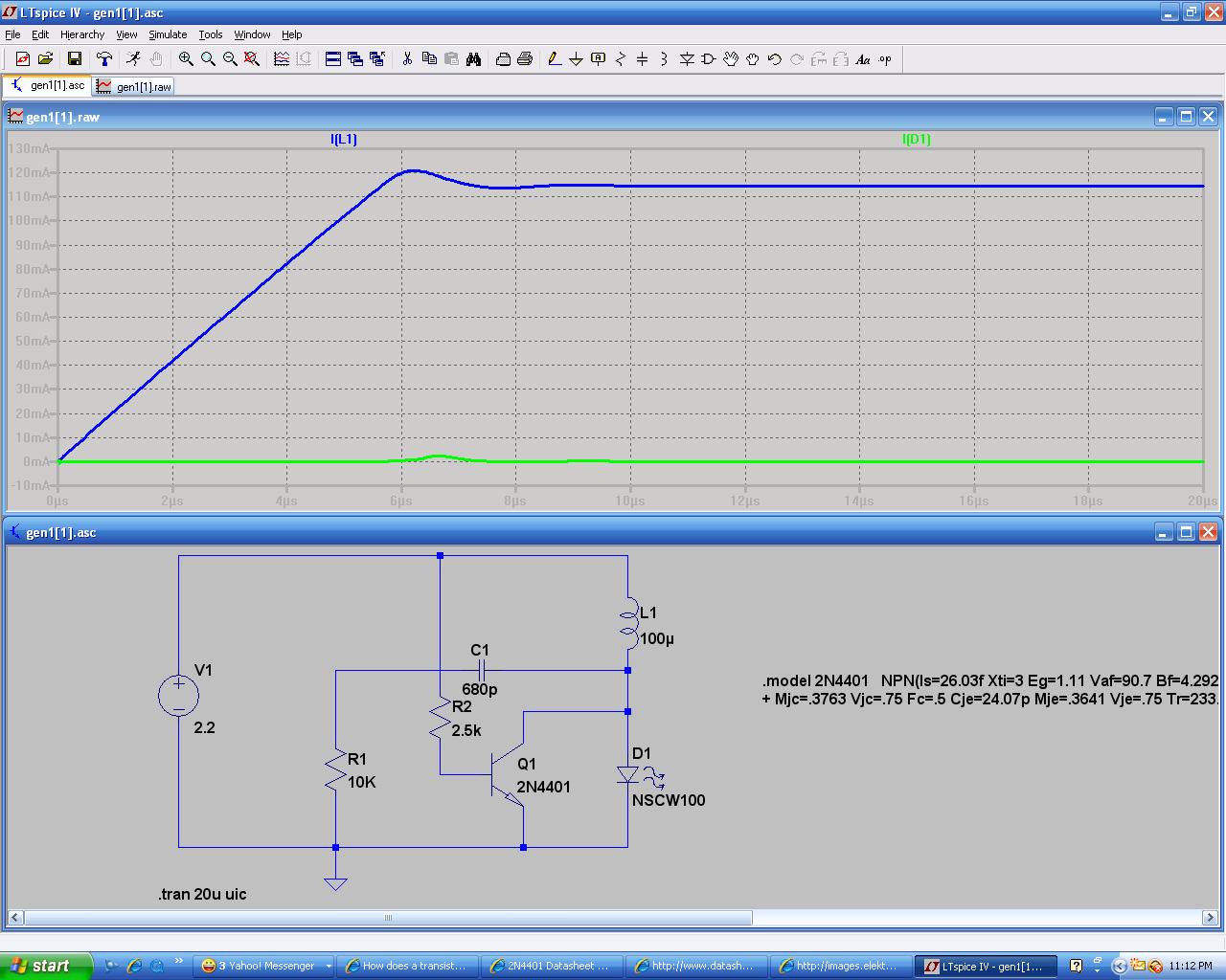

By disconnecting the capacitor, I see that the transistor operates permanently in the active region with no excursions into saturation. I surmise that on startup, the capacitor momentarily sends Q2 into saturation by making its collector the same voltage as the base of Q1 (0.7 volts). Then it latches and stays in saturation until the back voltage across the coil decreases.

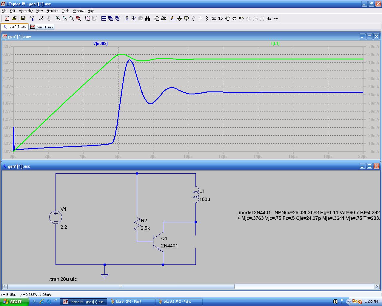

OK for this circuit
We assume that at time 0 Q1 and Q2 are full "ON".
The base current is equal
Ib_Q2 = (3V - 0.2V - 0.7V)/3.5K ≈ 600uA
And for sure Ib_Q2 remains constant (600uA).
At time 0 Ic_Q2 = 0A because almost all voltage is across L1.
The current in the inductor start ramps up in I =3V*t/100uH = 30mA/µs

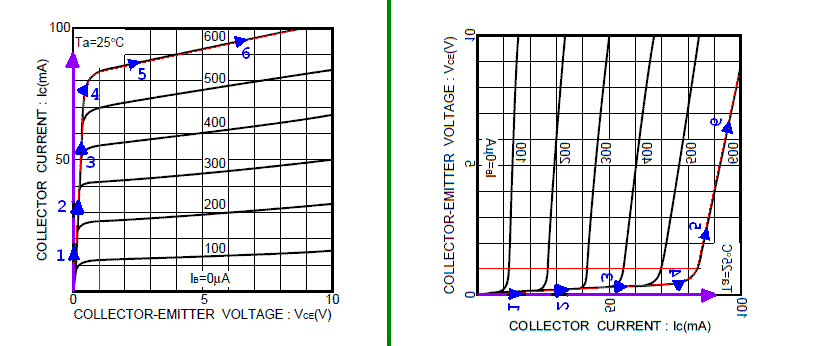

And form datsheet I get this DC output characteristics
An form LTspice for 2N4401
During the phase when a coil current ramps up (30mA per microsecond ) the operation point of a Q2 moves up the curve from point 1 to 2.
And when Ic_Q2 reaches the point 2 Q2 will start to come out of saturation.
So we need at least 120mA inductor current (and this will take 4µs) to Q2 come out from sat. And this will initiate the whole positive feedback stuff, which in the end cut-off all BJT.
So the primary cause for all BJT start to cut-off is Q2 that leaves saturation region and enter into active region.

Why are we talking about ideal coils? The coil has resistance, as does the voltage source and the transistor. That establishes a current limit. The coil's back voltage eventually becomes close to zero as it approaches its current limit.

Look at Jony's post! That plot shows Vce vs Ice. Now try to get out of that one :)
If you increase Ice (as the graph y axis) you see the sat voltage rise and then break out of sat at the knee(s).

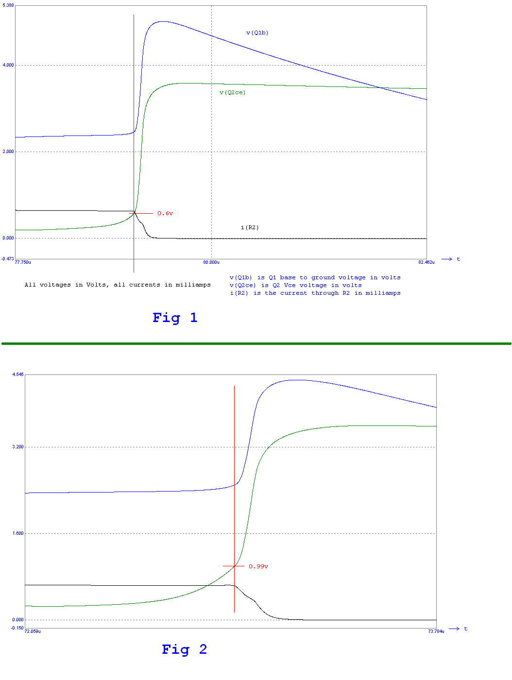

Hello again,
Here are two simulation runs for the Brinkmann circuit.
Fig 1 shows Q1 cutting off, but only after Vce starts to rise. The point where Q1 starts to cut off is after Vce rose about 0.6v, which means it's hard to tell what happens first (however it did actually rise not stay the same), so in Fig 2 the capacitor was decreased to 380pf and now we can see that Q1 does NOT start to cut off until Vce rises to nearly 1v (0.99v).
Now in the Fig 1 we might be able to argue that Vce only had to rise a little, so it 'might not' have come out of sat yet because Vce only equals 0.6v and so the feedback couples that to Q1 base. But, in Fig 2, Vce rises clearly to 0.99v before any action occurs in Q1, and so if we argue that in Fig 1 the transistor came out of sat at 0.6v due to the feedback then we can not also argue that the transistor came out of sat at a different voltage (0.39 volts higher than 0.6v) too because the base drive is the same in both cases (Q1 is conducting).
Thus, at the very least in Fig 2 the transistor Q2 comes out of saturation due to some reason other than the feedback and i dont see any way around this, and the only reason left is Ic increasing.

I removed the coil and voltage source resistance, and the circuit still runs fine. I surmise that the transistor comes out of saturation before those high currents are reached.
By disconnecting and operating as you say, you are working with a different setup then. You have to stick to what the transistor actually gets no matter what circuit you use. By using the correct circuit(s) you will see the transistor behave no matter what circuit you choose. By chosing the wrong circuit or different operation, you wont see it happen the same way. The circuit has to start from low current as the real circuit does if you are to use a different circuit, not from full supply voltage.
I disconnected the capacitor because you said in post #357 that the transistor will come out of saturation without feedback. It never goes into saturation without the capacitor, but instead operates steadily in the active region.

MrAl,
I agree that Vce rises very shortly before feedback starts. The data sheet shows Vce rising slightly with increased current. How are you getting such humongous Vcesat values when the data sheets show a much lower value? What is causing those values to be so high? Are they really transitional values of Q2 coming out of saturation? What caused it to come out of saturation?
Ratch

In the attached simulation, the Q2 transistor was replaced with a wire. At turn on, Q1 is in saturation, and goes out of saturation at 120mA, just as myself, Mr Al and Jony130 have said all along. Diode current is zero. The bjt leavs saturation from Ic only. The trace of coil voltage shows a substantial positive spike at the moment the bjt comes out of sat, just as we've predicted.
Here is the same result with the cap and diode removed, so we don't have to hear about how the current goes somewhere else. There is only the coil and bjt collector. The bjt comes out of sat with increasing collector current. The blue trace is the voltage at the coil/bjt node. Notice how it changes rapidly and significantly when the bjt comes out of sat. That rapid change in voltage feeds back in the original circuit, and forces the transistors into cutoff.

The following diagram shows the evolution of the collector emitter voltage as the collector current rises. The two plots are the same, but the second one has the collector current drawn on the x axis which is what you might be more familiar with seeing. In both diagrams the purple arrow shows the direction where the collector current increases, and the blue arrow heads point out the path we follow visually as the collector current rises. We then read off the collector emitter voltage for each point 1 through 6 and those points also correspond to 600ua of base current. You can follow either plot as we go, but the second one might be more what you are used to seeing. Note however that some of the numbers are drawn backwards but you can still tell what they are...that happened after flipping and rotating to get the plot in the right orientation to get Ic as the x axis.
Starting with 0ma collector current and then adjusting it up to point 1, we see that the Vce is very low. Increasing Ic more up to point 2, we see that the collector voltage rose a little more. Increasing more to point 3 the collector voltage again goes up, and when we increase Ic more we get to point 4 and now that is the point just before the transistor starts to move out of saturation. Somewhere just after point 4 the transistor can officially be called out of saturation, but continuing up to point 5 we see that the transistor is definitely out of saturation, and by point 6 the transistor is way out of saturation. Notice we never changed the base current, which in the osc circuit that is equivalent to no feedback.
Brownout's time plots show this nicely too...thanks for those Brownout.

Ratch,
According to the Fairchild data sheets, the transistor can easily exist in saturation at 500 ma, so just increasing the current to 120 ma is not going to hack it.
From ONsemi datasheet it's clearly shows that if IB is equal 600uA then BJT is comes out of saturation for Ic > 100mA
https://www.electro-tech-online.com/custompdfs/2010/08/2n4401-d.pdf
You use the familiar Ic/Vce curves to do this. I don't think that is valid because those curves are predicated on a reverse bias being present on the c-b segments of the BJT. If you were jumping from one point to another in the active region, then I would say you would be correct. But you start in the saturation on the left of the base current line, where the base current no longer controls the transistor, and the Vce and Ic can have a wide range of values.
And here you have the photo from very old Polish book writes by professor Jerzy Baranowski in 1976r.
Where he describes the principles of operation self oscillating DC to DC converter.
And he also start in the saturation on the left of the base current line.
Why? Becaues IB is still 600uA and Ic is less then 100mA, and all VCC voltage is across the coil. So BJT is in saturation.
