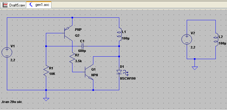

Again, the sequence of events is as follows:
1. Q2 turns on.
2. Current rises in inductor
3. Current exceeds that which Q2 can hold with it's current bias
4. Vce voltage starts to rise
5. Vcb gets higher, transistor comes out of sat.
6. Voltage rises Vce
7. Rising voltage couples through cap to Q1 base, turning it off quick
8. Q1 turning off turns off Q2
9. Q2 turning off gives rise to inductive kick back and high boosted voltage Vce
If you dont agree with that sequence of events then list your own idea of how you think it happens. You really should do a circuit simulation first though because it looks like you havent done that yet.

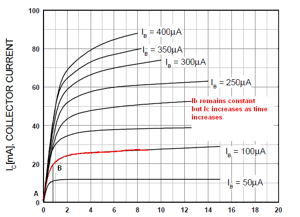

I have a slight issue with #6. I believe as collector current increases, the bjt comes out of saturation, and so the collector current changes from a linear rising one to one which is a constant, controlled by base current. The change in current is reflected in the inductor voltage: VL = L*dIL/DT. The rapid change in inductor voltage is fed through the cap, and the rest is as stated. The curcuit might oscillate without the rapid change in inductor voltage, but this makes the transition much more rapid.
What do you think? Mr Al? Jony130?
PS This happens too fast to be captured by the simulation. If we tried with and without an inductor, it might shed some light. I just got back from a sun-burning weekend at the lake and too tired to try it. Maybe later this week...
Hmm,
When Q2 is "ON" his base current remains constant.
And at the beginning, Q2 is in saturation and almost all supply voltage is apply to choke. So current in choke start to rise up progressively but Ib is remains constant.
But Ic increases as time increases. The operation point of a Q2 moves up the curve from point A to B. So Q2 comes out of saturation and in the same time Vce voltage rise to.
The voltage on C1 is (Vcc - Vbe - Vce_sat) so increasing Vce will cause Q1 base voltage to increase. This reduce the base current. So Q2 will enter into active region even faster, becaues Vce increasing (positive feedback).
So I think is all up to BJT and IB when transistor start comes out of sat.

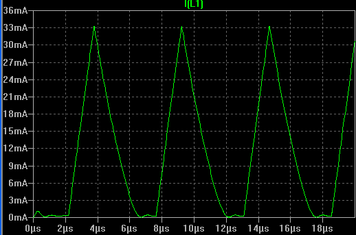

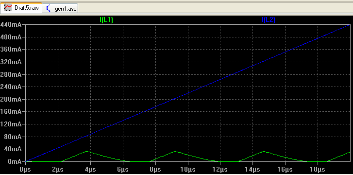

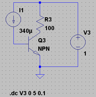

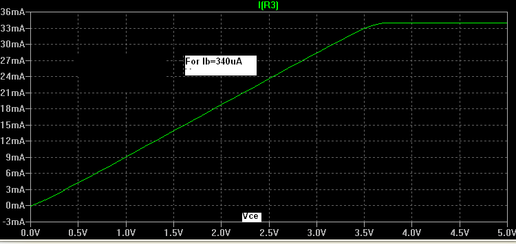

But how it is possible that ideal coil connect to the voltage source can not longer sustain a rising current?
PS look at this simulation (3 to 5 and gen2)
For Ib=340uA--->Ic stop rise at 34mA
And in the oscillator Ic stop rise at 33mA , very strange coincidence?

Jony130,
It is not an ideal coil. I modeled 0.2 ohms for the voltage, 1.4 ohms for the coil, and the transistor has resistance too. That limits the current. So the back voltage of the coil will be higher at first and less later. Therefore a positive voltage will be periodically applied to the base of Q1 via the capacitor to shut it off and bring Q2 out of saturation.
Ratch

In other words, we have to specify collector current and also base current to tell if the device is in sat.
Example:
100ma collector current and 10ma base current, transistor is (most likely) in saturation.
100ma collector current and 1ma base current, transistor might be in sat.
100ma collector current and 100ua base current, transistor probably is not in sat.
100ma collector current and 10ua base current, transistor is most definitely not in sat.
100ma collector current and 0.00 base current, transistor is not in sat.
So it's a matter of BOTH Ic and Ib, not just Ic.
I think what Jony was saying is that for an ideal coil (as in simulation) the coil can support any voltage you throw at it so there's no reason for that coil to force a zero voltage (across it) condition. Also, you have to keep in mind that even without that feedback circuit (Q1) the transistor comes out of sat, and that's with no feedback whatsoever.
Is this starting to make sense now?
I realized that another way to think about this is a simple circuit where we are driving a relay with a transistor...a very common thing. We want to provide enough base current to *keep* the transistor in saturation even with some temperature variation. The key word there being "keep". What is there to keep? It's saturation. We have to 'keep' it in sat because if we dont it will pull out if the beta (due to temperature change) drops lower than we thought could occur. As example, 1ma base current and 100ma collector current might work for a while when the beta is high, but as the transistor either cools off (due to ambient change) or heats up (ambient or self heating) the beta could drop (upside down skewed parabola of beta vs temperature).
Some resistance? It would need around 90 ohm for the current to stop at 33mA. That would be quite impossible, so the whole analysis is bogus. Here is your hint, from Jony130:
Of course it's not a coincidence. This is how it really works.
Jony130: I think for the resistive load you'll find that Q1 comes out of saturation first. Q2 really has no reason to come out, since the load is resistive, ICQ2 won't rise with 'on' time. The feedback current that keeps Q1 in saturation eventually dies down, and Q1 enters active mode, Q2 will quickly follow. The built up change in the capacitor added to Q2's sudden rise in collector voltage then turns off Q1. The coil makes the situation a little different. At least that's the way I think it works. If course it depends on the coil's charge time vs capacitor change time, and a few other factors. If Iwasn't already tired of the subject, I'd try to present a more complete analysis.
Hi Brownout,
Sorry to hear you're getting tired of the subject. I havent looked at the resistor only circuit for the oscillator, but i do know that any transistor will pull out of sat if the collector current rises too high. I guess we'll have to see if that happens with a pure resistance too. I think it would because with no feedback if the resistor is of a low enough value the transistor will come out of sat. So it may depend on the value of the resistor.
