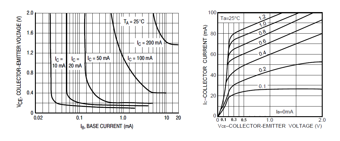

Thats becaues Ic-Vce curve don't come from the same manufacture.
The collector saturation region come from ON semi and Ic-Vce form Rohm.

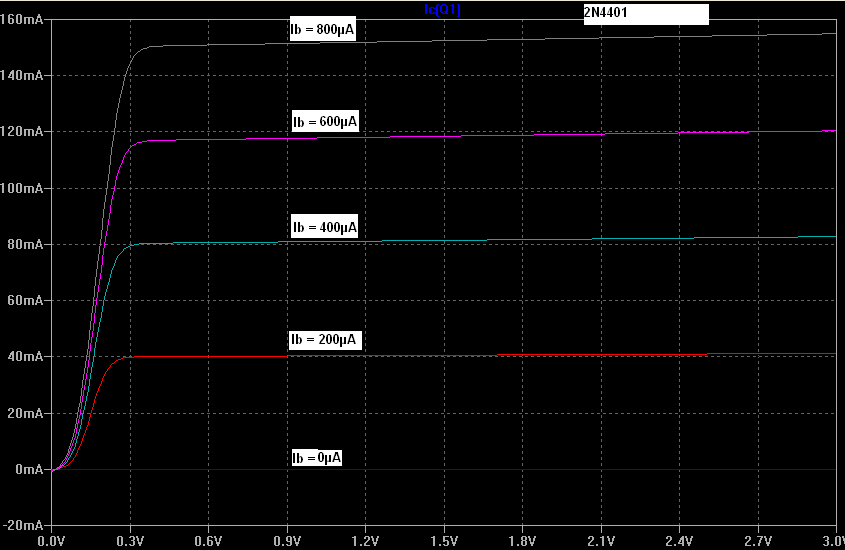

So can you show me how you get 120 ma?
Because we use the simulation model for 2N4401 I plot Ic = f (Vce) for Ib=const in LTspice (see attached curve)
And from Ic-Vce curve plot by LTspice it's clearly to see why in LTspice current stop increase when he reache 120mA.
And of course if we change IB then Ic current will stop increases by a different value of a Ic current (see attached file).

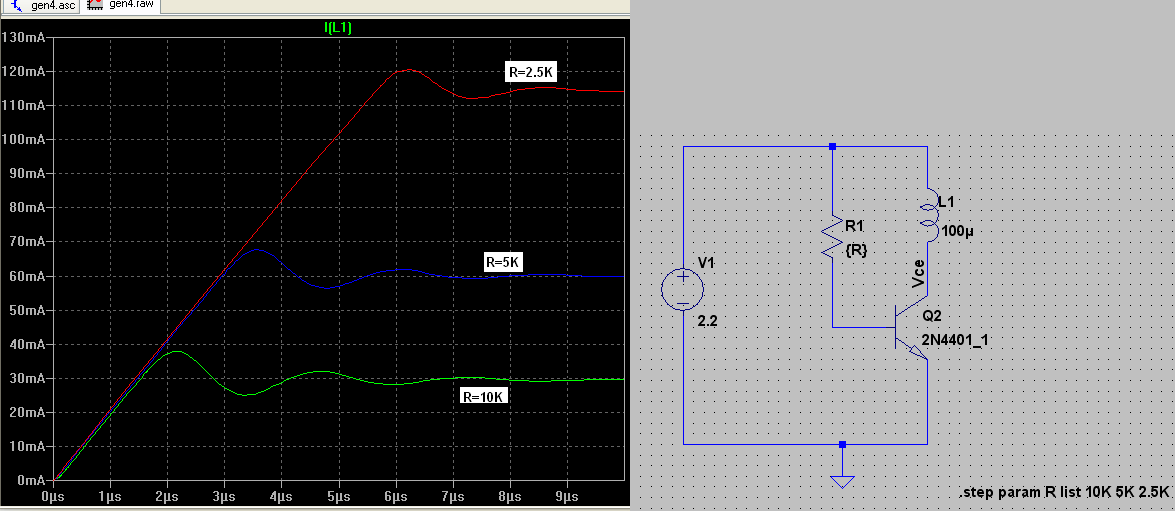

Another question, did you calculate the 30ma/µs, or did you get it from the simulation?
Why to use simulation for such a simple calculation?
I think that everyone knows this equation:
V = L * dI/dt so for constant voltage in the inductor equation look like this
V = L *ΔI/Δt
So if we want to know the rate of current change (dI/dt) in amps per second we simple calculate:
ΔI/Δt = V/L = 3V/100µH = 30KA/s = 30mA/µs
That Ic vs Vce is a beautiful graph. Where did you find it? Most of the data sheets don't even have a Ic vs Vbe graph
That is a good explanatory answer.
So the model parameters in the simulation are different than the manufacture's data? I find that disturbing.
V = L *ΔI/Δt
You are right, I am very familiar with that equation. I don't know why I did not discern that. I had a temporary lapse of preception, I guess.
Ok, you have made your point. If you use the correct model or curve, you can determine the point of departure from saturation. Does that mean that a real 2N4401 will follow the manufacture's data and come out of saturation at 85 ma?
