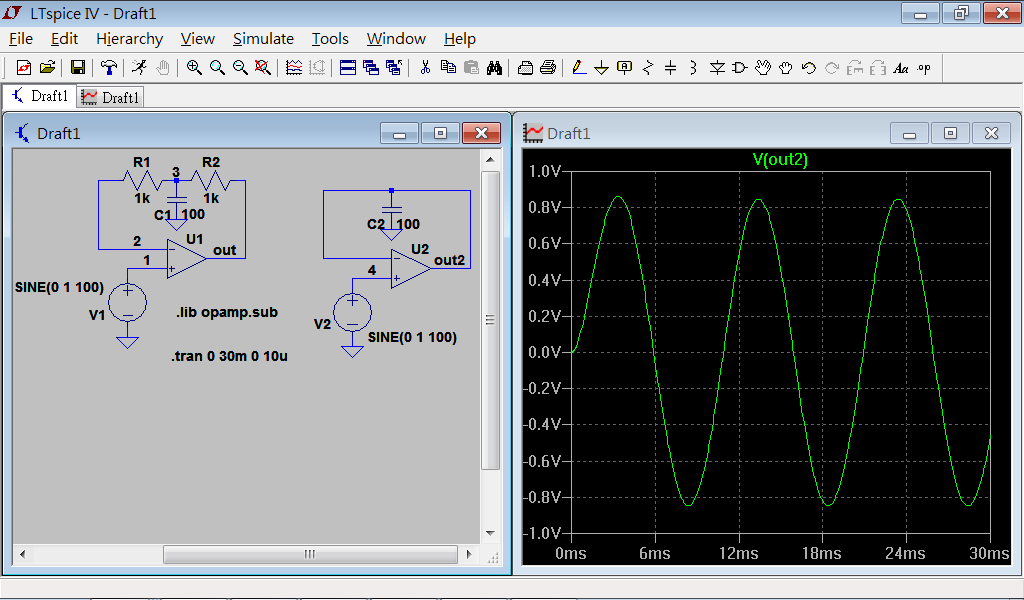

Can someone give me a hint about why the output voltage is less than the input in the right circuit? Where should I start to analyze it? The input is a sine wave with a magnitude of 1 volt and frequency 100Hz.
Both your circuits have the capacitor directly on the output, so the response depends upon whatever the amp's output impedance is. That's not a normal or proper way to connect the capacitor so there's no good reason to try to analyze those circuits.
That's why my circuit has a resistor between the output and the capacitor (on second look I realize that R1 is not needed).
The feedback circuit is a simple LP filter that rolls off the AC feedback above its corner frequency (in this case the RC time-constant is 100F * 1kΩ = 100ks for a corner frequency of 1.59 microHz).
(I realize that 100F is not a practical capacitance but the simulator doesn't know that). ;)
This means there is no significant AC feedback down to a below 1Hz , thus the output is the open loop AC response.

The output voltag magnitude in your top circuit is equal to the open-loop gain of the op amp only at very low frequencies. An op amp's gain will decrease with frequency, but for other frequencies, the output doesn't represent the op amp's gain for those frequencies. Is it correct?

You have it backward.
The voltage output of that circuit is the true open-loop gain at any frequency above a very low frequency (about 1 Hz for the values shown), since there is no significant negative feedback above that frequency.
If you look at the open loop gain in a real op amp's data sheet you will see a similar Bode plot.

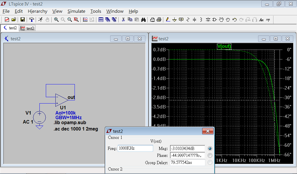

If we don't want the AC feedback to go to the inverting terminal, can we use the left hand circuit below and take its output as the op amp's open-loop gain?
As for the unit gain follower, the "gain" which is equal to -3dB at 1 MHz is refreeing to the voltage follower's gain, the open-loop gain of the op amp itself is still 0 dB at 1 MHz, is it correct? What else can the circuit tell us? The AC feedback totally go to the inverting terminal?

That may work in simulation with the ideal op amp model but any real op amp will saturate at one of the supply rails due to the high open-loop gain and the small input offset that all real op amps have.
Try the simulation with one of the op amp models for real devices with power supplies and you will see that it doesn't give the normal open-loop plot.
Yes, the unity gain follower output gain is obviously the gain for that configuration.
That has no effect on the open loop gain.
The circuit can tell you whatever else you might want to know about a follower (large signal AC response, transient response, etc.)
The AC and DC feedback transfer function from the output to the minus input is indeed 1. I don't understand your question mark for that.

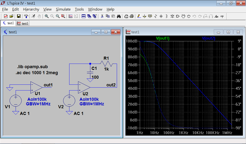

Hi, crutschow
For an op amp that its gain can be described by a low-pass RC filter, I can derive the relationship between its open-loop gain and frequency, and the result agrees with your LTspice simulation. But I'd still really like to know how I can fint Vout analytically. I only know that
Vn = Vout*[ (1/SC) /(R+1/SC) ] ---- (1)
Could you please give me some clues about how to proceed next?
For that circuit, except for frequencies below about a Hz, the output depends upon the open loop response of the op amp since there is no significant feedback.
In that case the open-loop response for a typical gain-of-one compensated op amp is typically a 6dB per octave roll-off (single pole) from the maximum open-loop DC gain to the unity gain frequency (GBW value) .

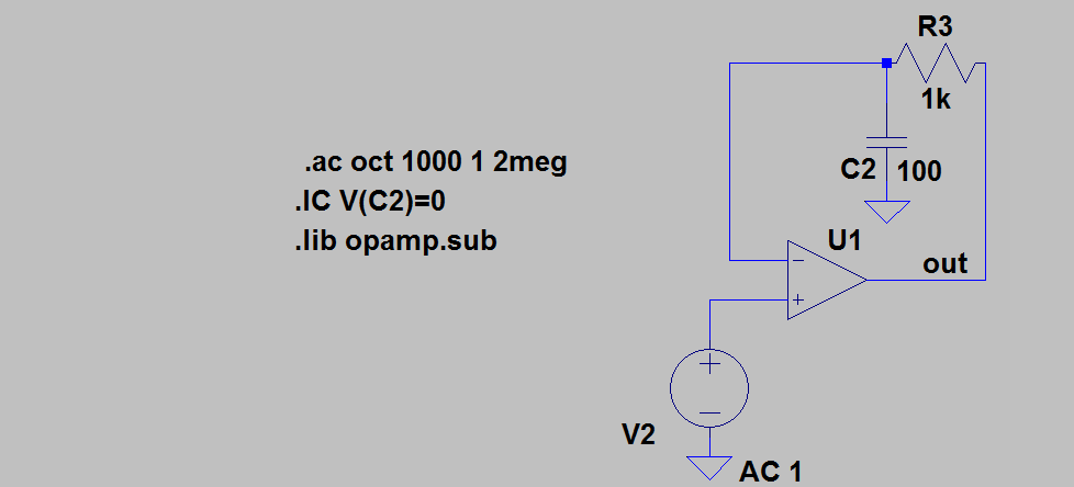

If I use a capacitor of, say 1nF, to force more feedback to appear at the inverting terminal, then that circuit will be more like a unity-gain voltage follower when frequency below perhaps 10 KHz. Is this correct?
There's one more thing I don't understand. Referring back to the original circuit with C=100 F, why is the output voltage so large? I thought it would saturate if feedback were not provided.
At first I think maybe we're using a (nearly) ideal 'opamp', but when I use a real one, for example LM308, instead, the output is still huge. Why doesn't it saturate?
The model might be using an arbitrary source to generate the output, rather than a full blown transistor stage. If you put even one transistor stage on the output you'll see it clamp to the supply voltage. If you put a theoretical controlled voltage source you'll see it go up to billions of voltage (ha ha).

The top is the open loop simulation.
DC feedback is provided by R1 and R2, with C1 suppressing the AC feedback down to a very low frequency.
In the top circuit in post #95, I think that in order to obtain relationship between the open-loop gain and frequency with that circuit, you have to know the voltage at the inverting terminal will approach zero above a certain frequency when there's no significant feedback, because Aol*(Vp-Vn)=Vout, since Vp=1, Vn must be zero so that Vout represents the open-loop gain. (Vp: voltage at the non-inverting terminal, Vn: voltage at the inverting terminal)
If I understand the purpose of that circuit correctly, I'm curious, "How did you know the voltage at the inverting terminal would approach zero with no feedback in advance?"
