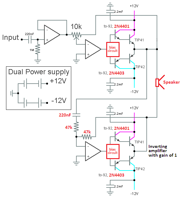

So when I bridge the amp I need to invert one of the outputs, what way do you reccomend? Referencing the circuit posted earlier in this thread in a link.
I forgot that you have a dual polarity supply so you do not need an output coupling capacitor. The capacitor is needed when you have a single-polarity supply and a single-ended output because then the output is at half the supply voltage and you do not want DC flowing in the speaker.
When two amplifiers are bridged then they both have the same DC output voltage so an output coupling capacitor is not needed.
I also forgot that your amplifier inverts so it is easy to make a bridged amplifier like this:

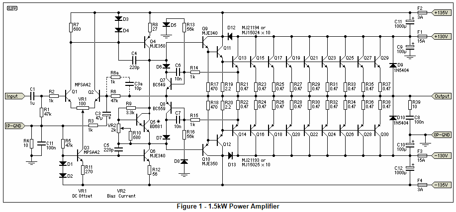

Is there a way to combine multiple driver transistors in parallel or similar for higher current handling ability?
Yes, high power amplifiers parallel many output transistors. Each transistor has its own emitter resistor so that the various base-emitter forward voltages are equal. Here is a high power amplifier:

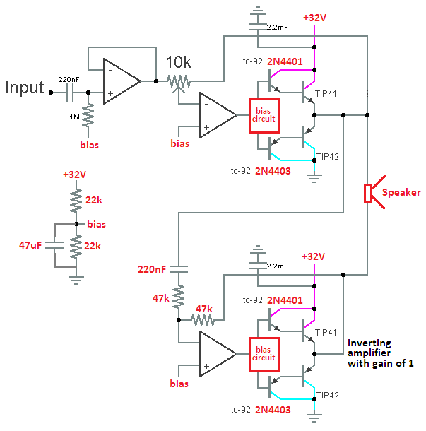

Any simple way to bridge it with it's single supply?
To boost the voltage I will be using lm2577T ADJ With a center tapped 12v transformer(12-0-12) wired with two diodes as a single rail supply(24v) then boosting that upto about 30v. Does this seem like a good idea? I figure the the more I boost my voltage, the more current the component draws right so I must be carefull with the current rating and not exceed it....My transformer says 2A on it. It dosn't have a VA rating...I got it at radioshack..
With two rectifier diodes, a 12V-0-12V transformer makes +16V. The center-tap is connected to 0V.
With a full wave bridge rectifier (4 diodes) it makes +32V. The center tap is not used.
I do not know how you calculated 24VDC.
Since the transformer can make +32V then a voltage booster is not needed.
If your transformer can supply 24VAC at 2A then it is rated at 48VA. Its peak voltage is 24V x 1.414= 34V. Its full 48W power at 34V provides 48W/34V= 1.4A.
A single-ended amplifier (not bridged) with a 32V supply produces 9W to 12W into 8 ohms.
The amplifier will be about 60% efficient so for 10.5W per channel the total stereo output power is 21W and the total stereo heating is 15W.
Your transformer might be able to provide 48W but this stereo amplifier needs 21W + 15W= 36W. Then a stereo amplifier driving two 8 ohm speakers will not overload your transformer.
EDIT: It is simple to make the bridged amplifier with a single-polarity supply. I show a +32V supply but then the bridged output power is way too high for your 48VA transformer at about 37W into 8 ohms. the heating will be about 25W.
