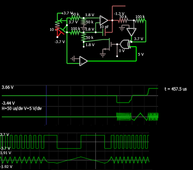

I made a FM Function Gen with a quad Op Amp with 60kHz/V and good linearity.
The cct. used a triangle gen and FET to invert polarity. It was also bipolar +/- Hz suitable for portable 3.7V pair. so 0 to 222kHz and 0 to -222kHz
using an XOR to invert the FET function.
