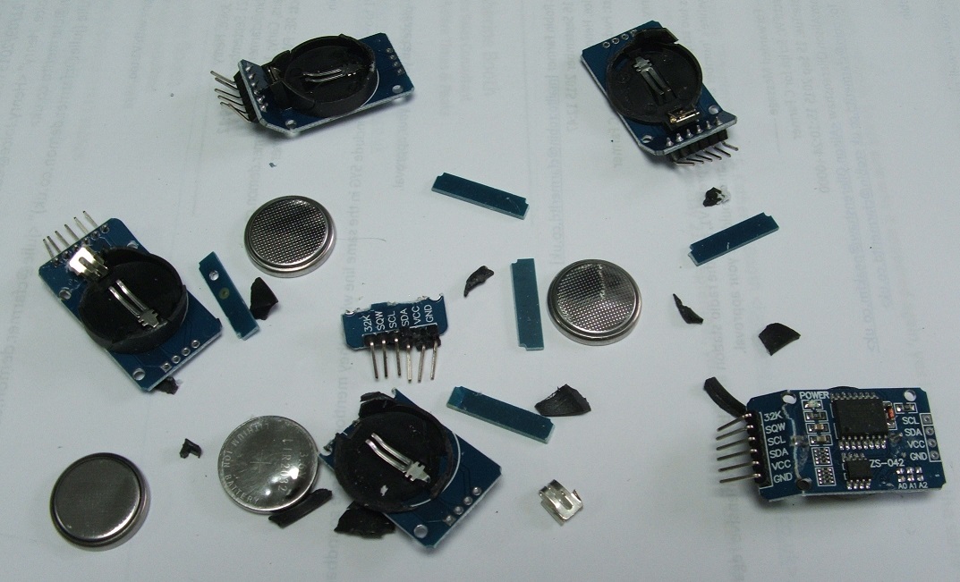

If you ordered through Banggood, I suspect it will replace them.
Hi!
Hi!
That image just shocked me. The modules look like they were put under the wheel of a truck. I'm curious how were they packed!!!
Nigel,
The three boards I got were each in a sealed bubble-wrap packet, and the three packets were then warped together in additional foam. The outer wrapping was as you describe.
Quality Control?
