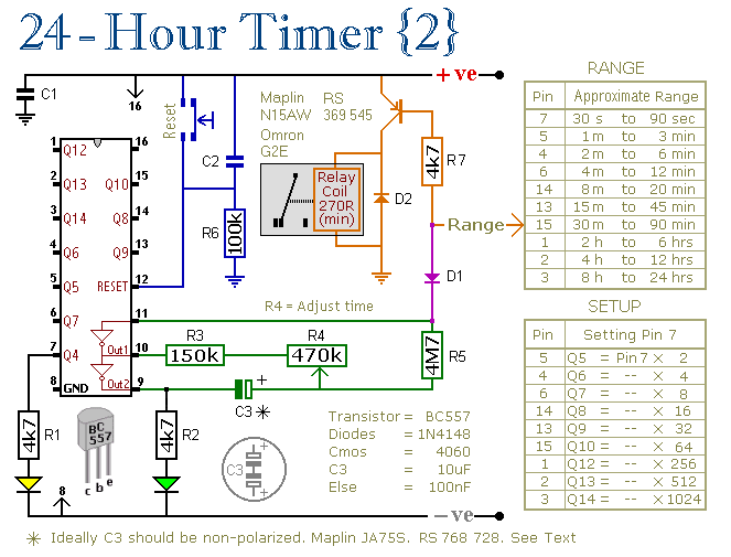

Friend I have attach a circuit diagram..... and I have also given a good detail as follows please help :
This is Three hour timer...
For a period of 3 Hours - the Range table shows that you can use the output at Pin 1.
Pin 1 to go high after 3 x 60 x 60 = 10 800 seconds.
And 10 800 ÷ 256 - is about 42 seconds.
I have Adjust R4 so that the Yellow LED lights 42 seconds after power is applied.
This will give an output at Pin 1 after about 3 Hours.
When pin 1 goes high - the relay will de-energize - and the timer will stop.
To start the timer again - you need to take pin 12 high.
The high must be a single pulse.
It doesn't matter how long it lasts -
The relay will energize immediately -
But the timer WON'T START TO RUN until the pulse ends.
When the alarms sound - the clocks will deliver a SINGLE high pulse to pin 12

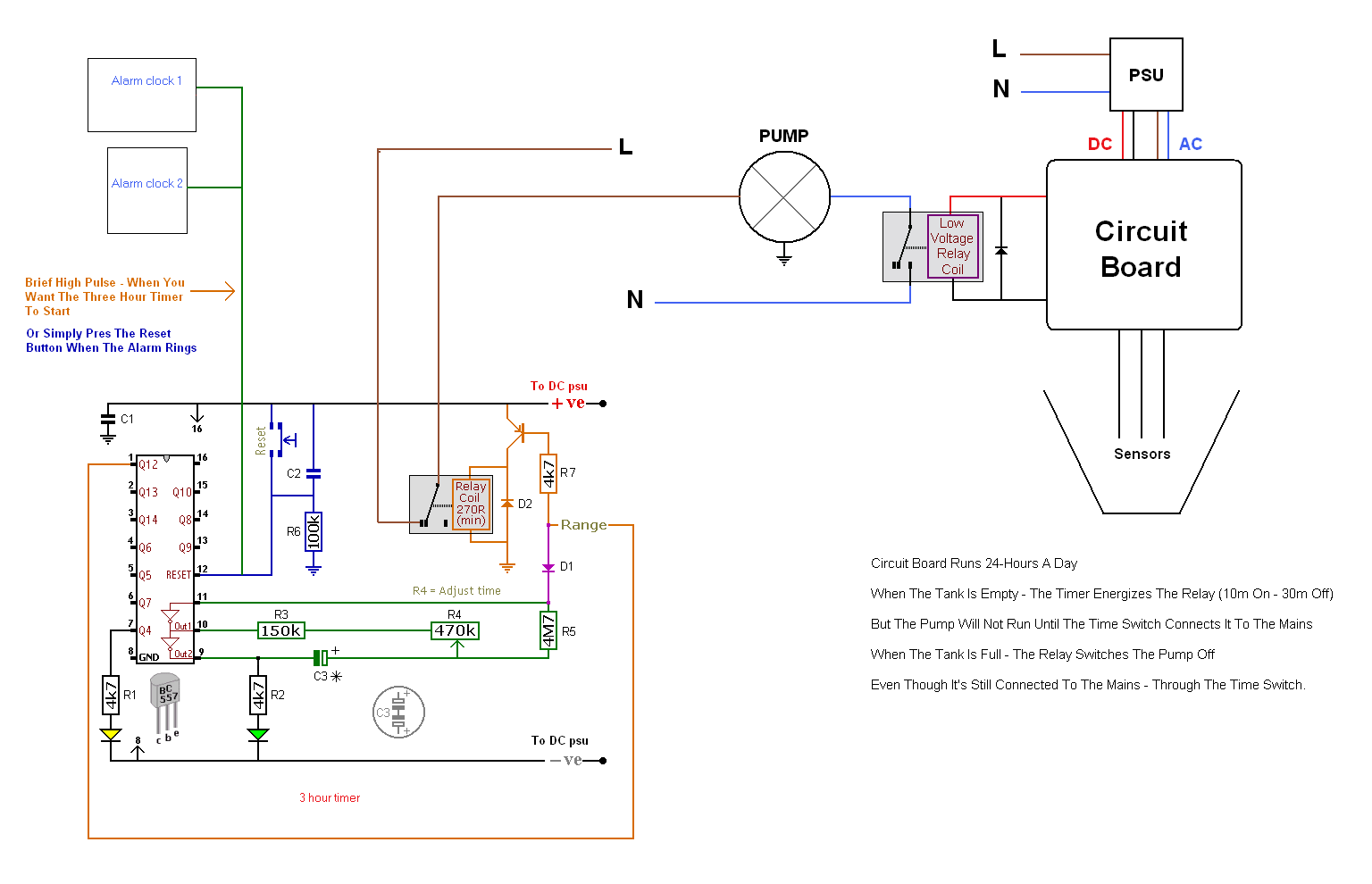

The alarm clock will simply remind the user to press the reset button and I want that it reset automatically.... without touching reset switch...
But I using the timer is "Single Shot" mode.
It will be RESET (restarted) twice a day.
So the 3hr output will always be the same length.
So............ friend i dont want to press reset button.... I want that it reset automatically......
Kindly help.............

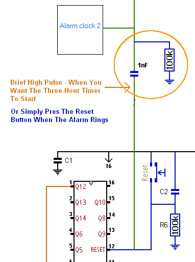

Try this mod to your circuit:-
hello... alec thanks for help..... but the circuit diagram you have send will it surely work as I have mentioned above... and second thing is if the alarm rangs it should reset this Ic and as it is ofcourse timer it will turn off after three hour.... automatically and again repeat this process as alarm rangs.....
Note : I using the timer is "Single Shot" mode it will reset this Ic two to four time a day...
Kindly help....

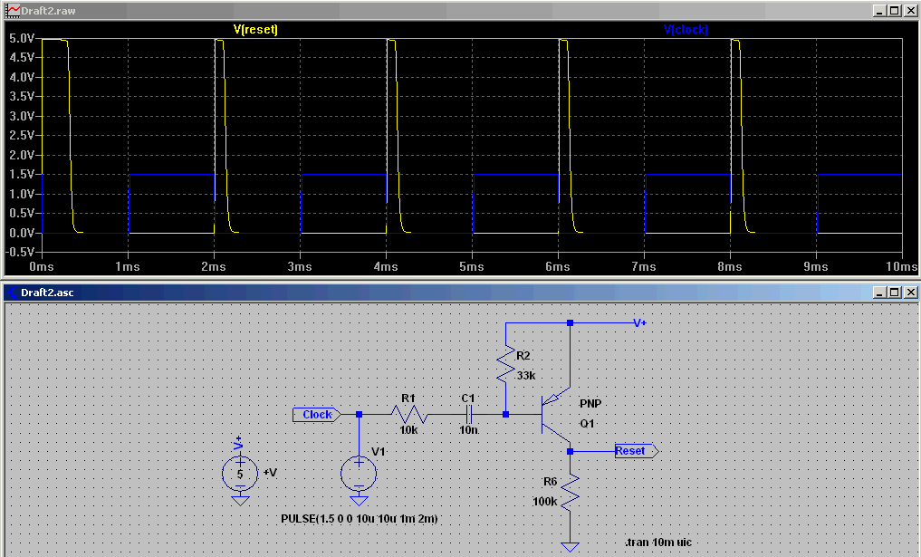

The circuit I suggested will do what you want provided the alarm clock can output a logic-high signal. However, many alarm clocks operate on only 1.5V, which won't be enough for a reset if your logic high level is 5V. Accordingly, you will need a level-shifter. The attached circuit should do the job. I have assumed that when the alarm sounds it outputs a 1.5V 500Hz square wave available at the sounder terminals. This will cause repeated reset pulses. When the alarm output pulses stop the counter will count to 3hrs. So your timed period will be the length of time the alarm sounds (1 minute??) plus 3hrs. In my circuit R6 is the same resistor as the R6 in your circuit. Note that in your circuit the L connection to the relay needs to go to the NO contact; not the NC contact as apparently shown.
