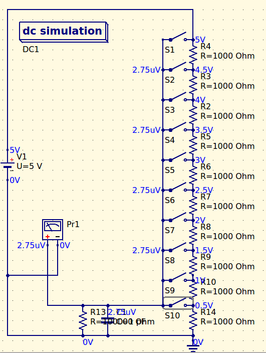

If you use 10 1k resistors and a large tiedown (50k) the voltage will be 0V for no press and 0.5V to 5V in 0.5V steps. Simple and obvious.

IF you understand how a voltage divider works and can make simple calculations
AND
IF you understand how the ADC works and the meaning of a ratiometric system
THEN the rest is simple. Some choices make it easier to make calculations, but it's just more convenient if you do so.
IF you don't understand that this is just a big voltage divider problem, you'll have no clue why your readings simply cannot clump around the middle of the range and you will jump to erroneous conclusions like "it would work properly with 1% tolerance resistors."

While laying in bed this morning it dawned on me that I have 13 junctions 2 for Vcc & ground, 1 for the 2 1K resistors and 10 for the switches so 1023/13 = 79 BUT Mike stated I need to account for the no button press??(1023/26= 39)
So my first switch should be 79+39 = 118

I understand what the circuit is supposed to do as well as the ratio between each adc output but the output is not correct.

Should be something more like this
function ADInAsVolt() as word
   result = ADC.Read(0)
end function
Select ADInAsVolt()
     Case <25
           'no button pressed
     Case <100       ' ideal=92
           'button 1 pressed
     Case <200       ' ideal=185
           'button 2 pressed
     Case <300       'ideal=278
           'button 3 pressed
     Case <400       'ideal=371
           'button 4 pressed
     Case <500       'ideal=464
           'button 5 pressed
     Case <600       'ideal=557
           'button 6 pressed
     Case <700       'ideal=650
           'button 7 pressed
     Case <800       'ideal=743
           'button 8 pressed
     Case <900       'ideal=836
           'button 9 pressed
     Case <1000       'ideal=929
           'button 10 pressed
     else
           'something is wrong
End Select

I suggest you read and understand the following. Barring that, the ONLY things you need in your code as far as this switch ladder is concerned is in blue below. Copy and paste NOTHING ELSE.
First, INCLUDE ADC.BAS. This is the module that handles the details for you.
Next, forget about the examples you have read. You do not want to convert the readings to volts. This is needless math and it's just wrong because you're operating from 3-something volts, so using Vdd as a reference where you are assuming it's 5 volts makes the numbers wrong anyway. You want the raw ADC output, which is a 10 bit number meaning it can range between 0 - 1023. A reading of 1023 means the level you are measuring is the same as Vdd, a reading of 512 means the level is 50% of Vdd, etc. We don't know what Vdd from your battery is and we don't care what the actual voltage is. The only thing we care about is the ratio of the measured level compared to full scale.
From the Swordfish help file, next we need:
// initialise <-------- this goes at the start of the program code, after subroutines
TRISA.0 = 1 // configure AN0 as an input
ADCON1.7 = 1 // set analogue input on PORTA.0
delayms (500)
This function is in the ADC module, and is what we will use to read the ADC.
function Read(pChannel as byte) as word <---------- This is in the ADC module. Don't put this in your code any place. You need to look at it to understand what you are doing.
ADResult as word
After making a call to Read, ADResult will hold the last ADC sample value.
So your brain freezes up at pChannel. It's just the ADC channel to read.
When you want to read the ADC value, this is what you use:
Read(AN0)
<------------- this reads the ADC
Now to do something with it. The value you read is in ADResult.
Select ADResult
Case <93
(this has all been explained in other posts. Figure it out from here)
Ignore the first 3 lines in what Burt posted. You don't want the readings in volts, as I explained above.
Delete those 3 lines (and insert NOTHING IN THEIR PLACE) and change line 4 to
Select Read(AN0)
The rest is perfect.
