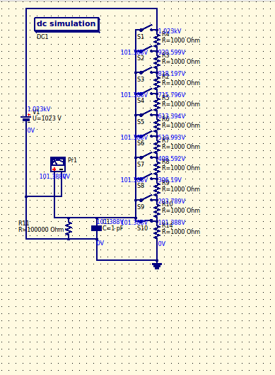

ADC read 80*500/1024= 39 why
he is doing that is beyond me 500/1024 = .488 you are cutting the adc readings in about haft
when you could of just used the adc reading you get with adc.read()
None of the 500/1024 is needed
I don't know why it works with or without?
I have 10 leds which indicate which section of the ladder is connected to the ADC input port.
Later today going to investigate further what is going on and hopefully why.
The code I posted in #209 works as well but not entirely, it skips one "switch" so adding the TRISA and the ADCON statements ddidn't seem to make much difference.
The reason I am using the 500/1023 is the fact most if not all the ADC examples use this.

You don't need to scale.
You don't need voltage you need 0 to 1023 that's it.
You would end up with 102 204 306 409 511 613 716 818 920 1023
And test 100 200 300 400 500 600 700 800 900 1000
Or do it the smart way print each switch out nock 10 off and test that.
If you add 51 and divide by 102 you get the switch number. I can here an echo in here.

This is because you are using the "adc *500/1024"
Replace this
FUNCTION Get_ADC_Sample() AS WORD // Function to grab the ADC sample for player position
result = ADC.Read(0)*500/1024 // Grab an ADC sample from channel 0
END FUNCTION.
with this..
result = ADC.Read(0) // Grab an ADC sample from channel 0
END FUNCTION
Lets assume for a moment that many people here understand how the ADC works, and know that the 10 bit ADC of the PIC will return a value from 0 to 1023 inclusive.
Lets further assume that the several people who have said the results for the button presses will range from about 35 counts to 900- some counts.
What happens when you multiply the ADC result by 500/1024? You cut the result just about in half. So instead of a range of 0 - 1023, now you have a range of 0 - 500. You are expecting results of up to 900-something, but now you get a maximum value of only 500. Half your switches can't possibly work with the values people have calculated and tested to be true.
So how about multiplying by 5000/1024? Now the values are 5 times too big.
Stop and think. People HERE have calculated and tested values for EXACTLY what you are doing. Calculated and PROVEN the values are correct. Do you think people here who KNOW WHAT YOU ARE DOING may understand more than example code completely unrelated to what you are doing?
If you have displayed voltages on the LDC, why can you not show RESULTS? YOU are the one typing what to display!

Mikes post is dead simple it would give a players number 1 to 10 based on the raw adc reading.
That is if he uses the ladder posted just like this one
using same circuit as post#236 but with 5v my readings are not linear as should be but will live with it. Using the function with just the ADC(0) only the "switch" termination reading tend to be way off. Am reading what the port input is then using 1024/5*voltage reading should be what is used in the CASE SELECT.
4.45 =911
3.97= 813
3.04=622
2.57=526
2.10=430
1.64=335
1.17=239
.708=144
.242=49
.224=45
Am I missing something?for not being linear.

Yes MrDeB Jon was displaying voltage your playing a game and Jon new what he was doing You want 10 players he wanted something else.
And seeing no one read's all this stuff we keep going on I done told you what you'd end up with all but the 43 you should not have 43 first reading should be 49 last should be closer to 1000 but why Your not guess you mixed some 20% resistors
I hand picked 10 they all read the same.
