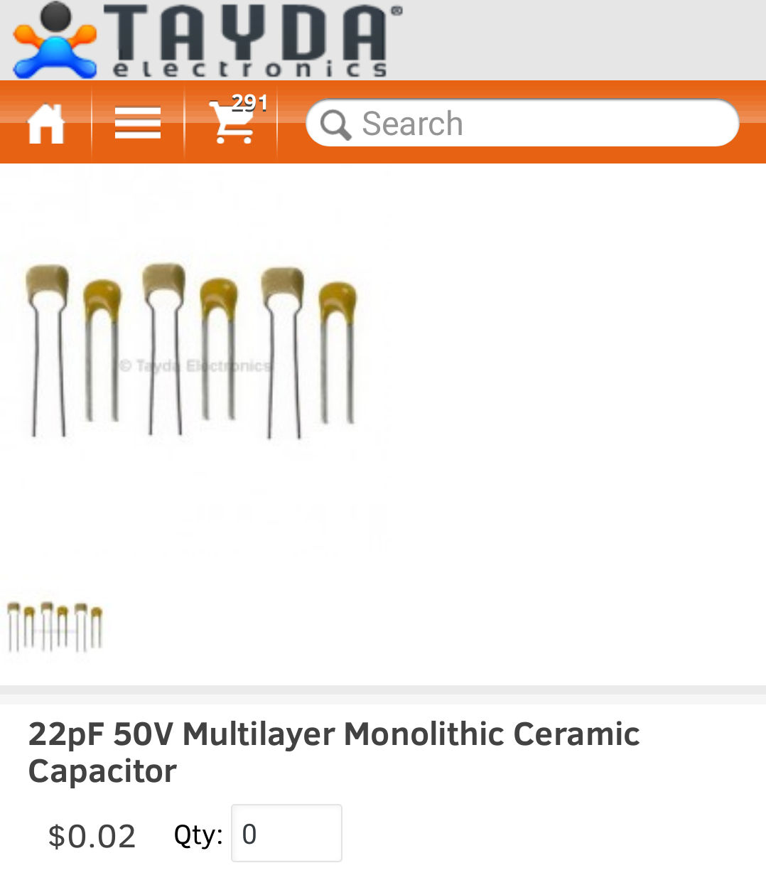

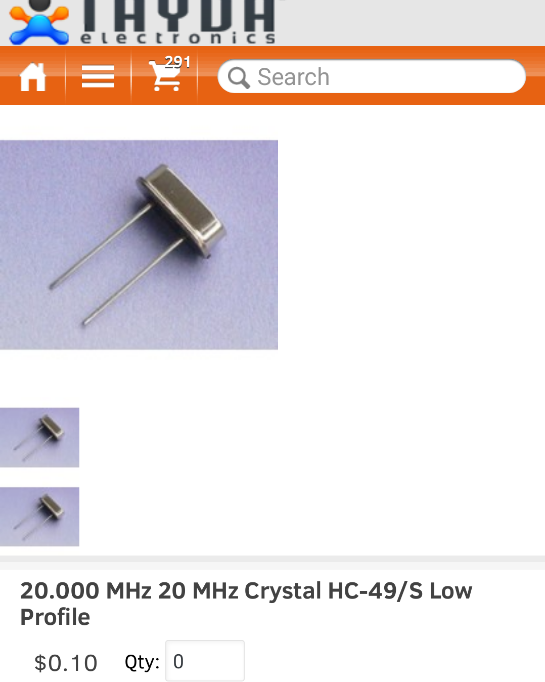

I have a bias towards things that just work and some people will disagree with this, but I always use a crystal. It just works. Every single time. Using the internal oscillator can be problematic in Swordfish, so I avoidcit. If you were building a thousand of these things, keeping the BOM as small as possible makes sense. In this case, time and simplicity are worth the 14 cents a crystal and 2 caps add to the cost. I did use higher quality caps, so you could probably squeeze that down to 12 cents if the budget is tight.
